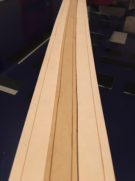

Last night I grooved my belts, and with any luck I'll start dying them tonight. Shortly after that I'll need to make a final decision, but until then I can keep looking at options around the 'net.
Grooving went ok, except some minor issues due to the new tool I decided to try out (unfortunately). That thing is going directly into the trash, that's for sure! Fortunately the worst issues were at the ends, which will either be trimmed off (the big belt in particular is longer than it needs to be) or likely covered under a loop to hide (in the back) or concealed behind pouches on the sides (depending on exactly where it ends up laying on me).

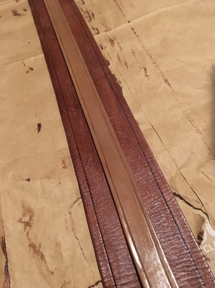

Progress made.
Slicked the edge of the outer belt (compared to unslicked inner belt):
Slicked the edge of the inner belt (comparison showing slicked vs. unslicked):
Dyed the two belts. Outer belt = Eco Flo Waterstain Desert Sand, Inner belt = Eco Flo Waterstain Light Brown:
I'll be putting another coat of light brown, possibly mixed with some slightly darker brown, on the big belt, to provide a little more contrast between the two. And then I'll put a top coat of Eco Flo Clear Gloss to seal it in, and I'll be applying Eco Flo Gum Trabanth to the back of both, for sealing and "shed prevention", as well as burnishing the back of the big belt some more. All in the name of keeping my Obi clean, LOL!
Once that's done, it's time to make final decisions on assembly methodology. For now, I'm sticking with the cheap "buckle" from the craptastic pleather belt, until I find something I like better. (I don't care for the one that I ordered, the actual thing was a lot smaller than it looked in photos.)
Then I get to start on pouches, and I'll finally be ready for photos!

Got the belts sealed, and started aging the big belt a bit. I think I'll keep the skinny belt smooth for now, and let it self-age. I need to finish sealing the and burnishing the back of the big belt tonight (gum trabanth and a big spoon, to keep it from shedding leather bits on my obi!), and I won't be able to put off deciding about how I'm going to put these two together!
