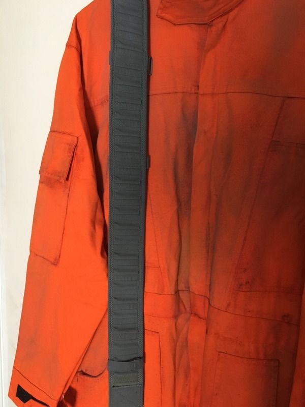

I used thinned acrylic on mine. The main technique was to dap an old T-shirt in the very-thinned and wipe it where I want dirt. It goes on thin, and you build it up realistically. I also did some spattering around the cuffs of the legs, and I some spot that I let set for 10 seconds and then tried to scrub out with an old tooth brush. The effect is of an old stain that the owner tried to scrub out.
I use Liquitex Raw Umber as my main color. It's the color of used motor oil.... ideal for this application. It sets up pretty well and you can wash the suit by hand and keep the weathering in tact (mostly), but it's easy to touch up if needed, just looks even more layered.
