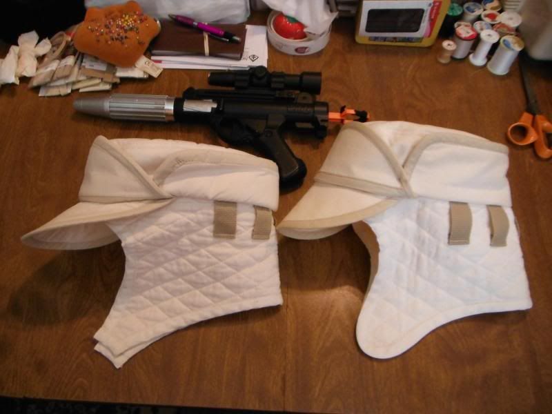

Here is my Hoth hat version #7 completed Jan 7 2014:
The differences with this hat are:
Fabric: It is a cotton fabric. This particular fabric I am pretty sure that I found in a collection of scraps that I inherited a few years ago. It is a slightly coarse cotton, but still fairly thin. It may even be muslin.
I attached the front flap first, then attached the visor. That must have been where I ran into problems with this when I originally started to build it (possibly in late 2007)
I hand-sewed the bias-tape onto the lower part of the hat, so there is no visible stitching.
I rounded the 'points' on the lower part of the hat and used one continuous piece of the extra-wide double-fold bias tape.
Here is my version #2 hat (left) and the new version #7 (right)

I decided I needed to re-do some of my original 2007 hat pattern pieces, especially the lower back piece. Here are the pattern pieces with my notes. Notice the kahki thread in my serger. It is a big pain-in-the-butt to change the thread.......
Detail of the hat band piece and the back top flap.
Detail of the hat crown, hat band and visor pattern pieces. A little while later I decided to re-do the front flap and visor pattern pieces before I cut the fabric.....
The new 2014 hat lower back piece.
I started to access the fabric that I had left from my costume build. I originally purchased 9 3/4 yards of this fabric for my costume. I had approximately 3 yards left including some odd pieces like this one that i had left over from cutting out the belt. I decided that I would cut out more bias strips (~2 1/2" wide rough cut) to make the double fold that will go around the lower back pieces of the hats. I could use pre-made bias tape for this, but I figured that if I do this, the fabric will match exactly.
Here are the pattern pieces lying on top of a triple fold length of my fabric. I realized that I would not have enough fabric to cut out the pieces for 3 hats. OH NO!! But after several hours of 'making it work' I was able to use all of the odd-ball left over pieces to cut out all of the pieces that I would need. I figured that I could use an alternate fabric for the hat linings if I was really desperate. I ended up only having to cut out one piece (a hat lining crown) out of another fabric.......whew!
Next, I started cutting out all of the batting pieces. I used this kind of batting for this.
Then I cut out the interfacing pieces......Here you can see the new pattern pieces I made for the front flap & visor.
The original pattern piece I made in 2007 did not account for the seam allowance. I used that piece as a template for the interfacing.
Then I started to fuse the interfacing pieces to the fabric pieces. Here is the new pattern piece for the front hat flap along with the fabric piece cut out and the interfacing piece cut out.
Here is a trick I discovered recently. Parchment paper. I can turn up the heat to the max on my iron when I use the parchment paper so that I can get a really flat and thorough melt when fusing! I am taking a lot of care preparing all of these pieces now, so that in the future, the finished hats will be extremely durable. Yes they will be able to be washed, dried and take a lot of punishment.
I figured I better take some pictures of what I was doing here......Here is one length (about a yard and a half) of the rough-cut bias strip. First I pressed it in half down the entire length. Then I folded it in quarters and lined it up perfectly on my cutting mat.
Then I aligned my metal straight edge on top of the fabric. Then I cut through all 8 layers of the fabric with my rotary cutter. You can see the cuttings from the previous strip on the right.....
Here is the perfectly cut strip ready to be pressed into double-fold bias tape. I made 3 lengths like this. Then I did all of the pressing..........
Here are all of the pieces layed out to build 3 Hoth Rebel Trooper hats. There are well over 100 pieces, probably around 150. Now I will change the thread in my serger to the cream cones (back of photo) .........................
The next thing that will need to happen is quilting the lower back pieces of the hats. First I drew out the sewing guide lines on 3 of the fabric pieces........
I sandwiched a piece of batting between 2 layers of fabric making sure that I have the outside of the fabric facing out on both layers. Then I spent a couple hours carefully pining the fabric in the center of each diamond.
Detail of the pinned pieces.
Then it was about 10PM and I was beat from doing all of this all day & night.
Posts: 17274
PostPosted: Tue Feb 18, 2014 8:15 pm    Post subject: Reply with quote
Thank you again for sharing all of this AWESOME information!!
TKvanB (Kathy van Beuningen)
Joined: 04 Sep 2002
Posts: 460
Location: Chicago
PostPosted: Thu Feb 20, 2014 2:03 pm    Post subject: Reply with quote
I started sewing the quilting lines into the fabric. Best way to do this = chain the pieces through. Sew all of the parallel lines in one direction first. ALWAYS sew the fabric in the same direction.
Sewing the pieces in a chain, not only saves thread (and this uses a LOT of thread) but it also eliminates all of the thread ends that will get tangled together unless you cut them off right away.
Here I am sewing all of the lines in the other direction to form the diamond pattern.
Here is what all 3 pieces look like after I sewed all of the lines. At one point, I sewed a group of lines in the other direction and I got a little pulling/twisting in the fabric. I am not sure whether this will be a major problem and need to be re-done.
Closer shot of the quilted fabric pieces.
I took out all of the pins, then I basted the edged of the fabric in the sewing machine.
Then I ran the pieces through the serger to even the edges. I did this because I am going to wash these pieces to wash out the guide lines I drew in. I can hardly see them, but I know they are there. These pieces will still be trimmed down further as I fit them into the hats. I just want to make sure that I have more fabric there than I need. It's easier to cut off excess than to have to add.
Next I pinned the front flap and visor pieces together.....
....basted the seams.....while watching Olympic curling....Norway vs Great Britain tie-breaker.......
.....ran the seams through the serger.......
Pressed the stitching.......
....turned the pieces and pressed them again.......
Then I fitted the pieces to the stabilizer. I drew the shapes of the pieces onto the stabilizer, then cut. The pieces of stabilizer will need to fit inside the pieces perfectly.
I slid the stabilizer pieces inside each piece, then top-stitched the seam edge first. Then I basted the open edges of each piece so that the stabilizer would stay in place better while I fit the pieces onto the hats. And I am still watching curling.......
Here are the visor & front flap pieces with the edges stitches. Then I put together the hat back flap pieces together. Outside of fabric facing out with 1 piece of batting inside........
....basted these pieces together.......then I ran the edges through the serger......
Then I put together the hat band pieces. I have decided to wait to make the linings later, after I have the rest of each hat put together, so I can make the linings fit inside better.
Here are the 3 hat bands sewn together at the front & back seams.
I have all three of them pretty much at 12" (24" all around) At this point, I decided to work on one hat first to see how big this will turn out to be. I want one of these hats to fit me, so I am going to have to see how big of a hat this will make.
First I wanted to see if the pieces would fit on this size band. Right now, what I have done, these pieces will fit this size band. If I need to , I can cut down the back flap to fit if needed.
This is what the overlap of the pieces should look like on both sides. This is the correct amount of overlap.
Then I started to put the pieces together to form one hat. Here is one piece of hat crown, sitting on top of one piece of batting. I have the hat band sitting on top of that. I serged both the top and bottom edges of the hat band construction so it would all stay together while I work on the hat.
I ended up cutting about 1" out of the back seam of the band so that I could fit it to the hat crown. This is a point where the sizing can be adjusted. If you pin it to be smaller, the hat will become smaller -- but beware - once all of the pieces of this are put together, it will add a LOT of thickness to the inner dimension of the hat. I sewed the hat crown to the band........
Then I pinned the front and back flap pieces on again to check that they would still fit. I decided that the pieces were a correct fit, so onto the next step.....
I cut & pressed into shape pieces of the contrast double fold bias strips to fit the shapes of the front flap.......
....back flap.....
....and visor. By pre-pressing these pieces into the correct shape, it will minimize potential puckers & creases.
I pinned the bias pieces onto the back sides of the hat pieces and sewed them on.
Then I folded the bias strips over and sewed them onto the front. These look slightly uneven. Pressing will correct a lot of this, but I think for the next group, I will sew them front-to-back.
I used my tailor's ham to press the visor & front flap to get more of a curve to the shape of these pieces.
Here is the front flap on the ham after I pressed it.
Then I pinned and basted the back flap on the hat, lining up the center of the flap with the back seam of the hat band. I then pinned the front flap in place.
Here it is lined up in place. I sewed it on and moved to the visor......but then I realized that I would need to sew on the front flap contrast piece that is between the visor and the front flap. I had to take it apart and sew on that piece of contrast. SO, for the next hat, I will sew that piece on FIRST, before I sew on the double fold. I will take more pictures of that when I do it.
Joined: 04 Sep 2002
Posts: 460
Location: Chicago
PostPosted: Thu Feb 20, 2014 2:45 pm    Post subject: Reply with quote
Day #4 of the hat build continues.......
After I had initially sewed the visor in place, I realized that there would be no way to neatly add the horizontal piece of single fold bias fabric onto the front flap. SO, I took the visor and front flap off the hat and loosed the ends of the double fold trim so that I could sew that one piece in place. Than I re-attached the front flap in place and fit the visor back in. I had to hand-baste the visor in place, because I could not get the construction under my sewing machine needle and be able to keep it straight. After several hours of monkeying around with it, I got it to the correct form.
Here is the side view where the pieces join.
Detailed shot of that area. Yes, it is still a mess, but that will be resolved.
Detail shot of the other side.......
What it looks like from the inside......
I wanted to see how the goggle fit on the hat. Side view....
Front view with goggles on the hat. I decided that I was satisfied with how this looks, so I moved on to the next part.
....meanwhile....earlier in the day I machine washed and dried the 3 quilted lower back portions of the hat constructions. All of my pencil marks washed out and the fabric got a nice texture to it. I then cut 3 lengths of the fabric tube that I made and pinned them onto the back of the hat. I KNOW that this is not how the screen used hats were done. I am pretty sure those pieces were added later as an after-thought. What I am making is the "better" hat. I know that the goggles straps placement will be an issue. I am resolving that right now by sewing them into the seams, as well as the ear-com flaps. Here they are all pinned in place. I will baste them at the seam line and the.......
.....fit the quilted lower back portion of the hat in place. For this particular hat size, I had exactly enough fabric to go around the hat. I didn't take pictures of the next bits of sewing because it was really intense. I will try to do so on the next hat, because this can be very tricky to do and will likely involve doing it over several times to get it to look right.
Here is the hat turned right side out, but the lower portion is pinned in place. I am trying to decide whether it is even all around......
....what it looks like turned back, but still pinned in place.
....some time later, I got this thing to come together evenly and I sewed it in place. Then I sewed it all in place some more to make sure that I have several rows of thread around the seam-line. This thing is not going to come apart without extreme effort. Then I started to pin the double-fold bias strip onto the outside of the hat, over-lapping at the front seam...
Here is the bias strip pinned in place. I sewed it on. Right now I am debating whether or not to hand-sew it in place. Hand-sewing is much slower, but I can get it to lie much nicer than sewing it with the machine.
.....and that's where I left off last night.
