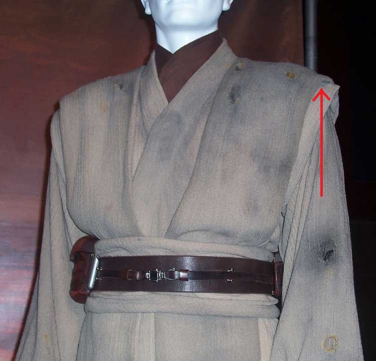

P.S. One detail that makes the Episode III Tunic set stand out a bit different from the Episode I and II Tunic sets are the Tabards. Not only are they longer in the front when compared to the earlier versions of the costume, but another detail that often gets overlooked by most fans replicating it, is that where they lay over the shoulders, they are about an inch narrower than the edge of the shoulder tuck so that the tuck peeks out just a bit. Note where the arrow points in the following shots to illustrate this. I think the narrower width on the Episode III actually give the Tunic a very different silhouette.
