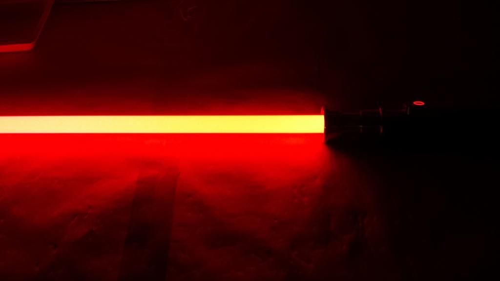

OK, I promised something else and here it is......
I was never really happy with The Ranger. It was fun to build a Graflex style saber but I got no use out of it and could not see myself using it. Not to mention, the one I built was a little too big to look right. It was one of my first attempts at board soldiering on a Sound Card and I was not sure of myself and my abilities so I left extra room. This resulted in a Graflex that was too long to look right and all it did was sit on a shelf.
Anyway, I have been pondering the idea of a Dark Jedi. No, Tymae Yarmoo has not gone to the Dark Side, but I was contemplating the idea of a nemesis. A Jedi who started on a similar path, but the great Jedi purge that he survived took him in a totally different direction, to the Dark Side. I even wrote a back store for this character (yes, my imagination gets the better of me at times).
I wanted to construct the character's lightsaber. I decided that since The Ranger was not getting any use, I would re-tool it. My goal with this project was to make a saber that did not immediately read as a Dark Side saber. it was to look like a Jedi's saber until the blade was ignited and then you get to see the true nature of the user.
I used an emitter that I have used before but I put a 3/4" extension in before it and a trim ring to give it a whole different look. I also made a new grip out of the TCSS sleeve material and shaped it a little bit. I put a d-ring on it because this guy is post Clone War Era.
The switch has a red ring LED in it and the blade color is what TCSS calls red/orange. I think it is a nice choice for this saber since true red just screams Sith, and this guy is not a Sith Lord. This has a more natural look to it, in my opinion and a subtle difference that sets it apart from the Sith sabers.
Enjoy the pictures and tell me what you think.....
In the picture below you can really see the orange in the red. It is a very good representation of how it looks in person. I think it looks like fire. Very cool color.
May the Force be with you.
