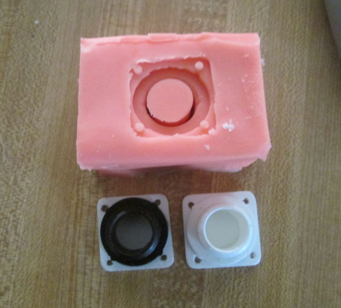

Well...I molded the piece I made and as I suspected....
since the mold material had been opened quite some time ago...it wasn't in prime condition. I have found that molding supplies don't have a very long shelf life...
anyway...
this is how it turned out...
the original piece..the mold...and the cast from the mold

What did you use to make the mold? What I use doesn't seem to come out that crisp...
That is "Rebound" from "Smooth-on and can be found here:
http://www.smooth-on.com/Silicone-Rubber-an/c2_1115_1132/index.html
and it is cast in in
Smooth-Cast® 300 Series Bright White Liquid Plastic
found here:
http://www.smooth-on.com/Urethane-Plastic-a/c5_1120_1209/index.html
The site has extraordinary video tutorials...
like this one:
http://www.smooth-on.com/video_play.php?video_id=TgLKwMV7NbM&autoplay=1
I have used the OOMOO several times also...

Ah, thanks for the information.
I gather you just pour the Rebound into a small container and press the piece to be copied into the liquid?
Posts: 17280
PostPosted: Tue Aug 13, 2013 8:31 am    Post subject: Reply with quote
no....it is a little more complicated than that....
I would watch the video link I gave you above...
item is glued down (I use a different procedure than they do-I use a decoupage glue thinly to the entire base of the piece and glue a piece of paper to the bottom...then place the piece w/paper attached into a box).
Then you use the sealer...
then the release agent....
and the mix is made - 1 to 1
If you are doing something with small details then you brush a couple thin layers on (see this video - http://www.smooth-on.com/video_play.php?video_id=ZCIO_2J1gF0&autoplay=1 )
first to capture the detail....
For the one I made above...I knew the mold material was old (as stated...the shelf life is not great) so I just mixed the A and B and poured it over the piece and tapped the box with the piece on the table to release bubbles.
Normally ...you get no bubbles in the mold
....but...again...old product...I did have a few bubbles in the mold....which then can be seen in the final product when cast.

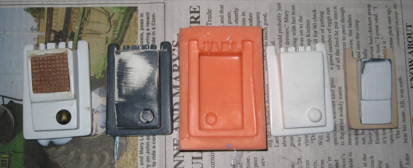

Here are a couple more examples...
The Hoth Wrist Comm I made out of wood....sanded ....sanded...sanded...
and applied a coat of primer....made a mold and cast...
The one most of the Snowspeeder Pilots use is this one - also made from wood.....and as you can see....a couple attempts..:

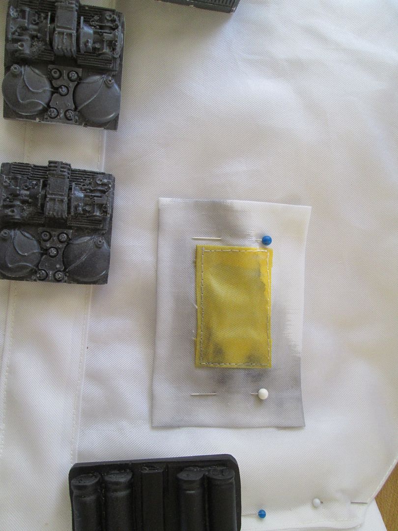

and the weathering technique I am planning on using...
the infamous yellow square with the black wash while wet
and dry
