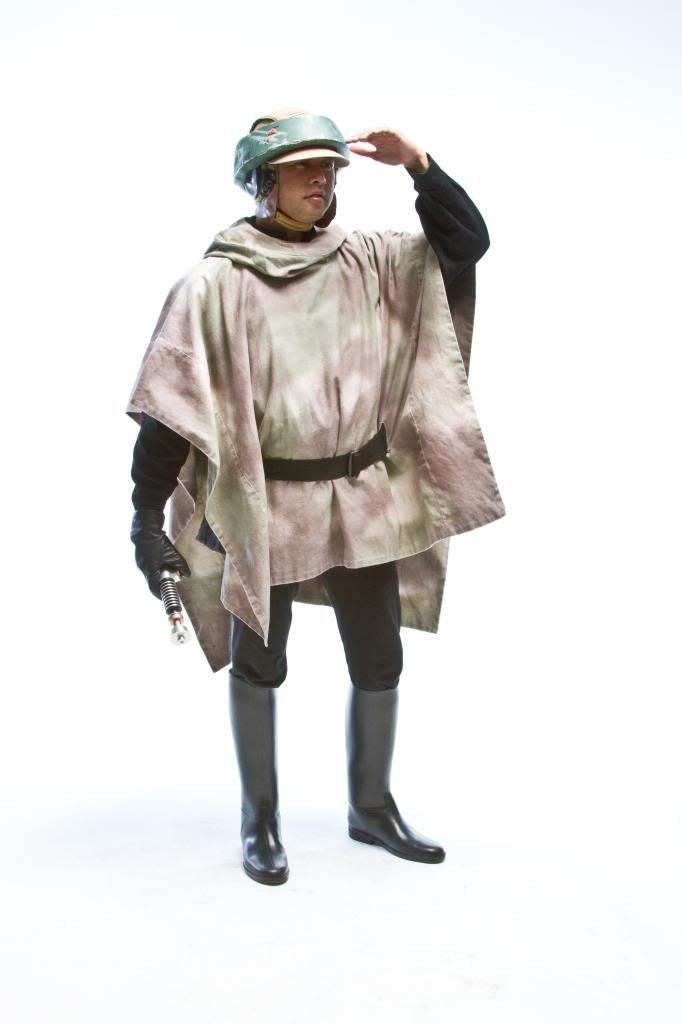

I forgot, I have some shots of my poncho that Vera made (front, side, back) that shows how it hangs, both with arms up and down, if that might help.

Those pictures are awesome, Matt! And helpful. I'm logging all this in my memory because I've got this Leia costume on my radar...still in the parts gathering phase.
