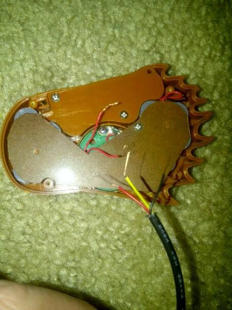

trying to hook up sound for Chewy since I cant do the sound myself.
I got an Aker 20 amp (which I think is over kill now, could of went with a 12)
with help from Woulf, I was able to wire it up.. awesome! sounds great!
quote from Woulf on how to wire it.
Quote:
if thats a headphone jack, with a 1/8" plug, try putting the yellow to one of the speaker wires, and then the black AND red to the other. if thats what you have, the yellow is the case ground, and the black and red are your left and right. since you have 1 output, put them together and try it.

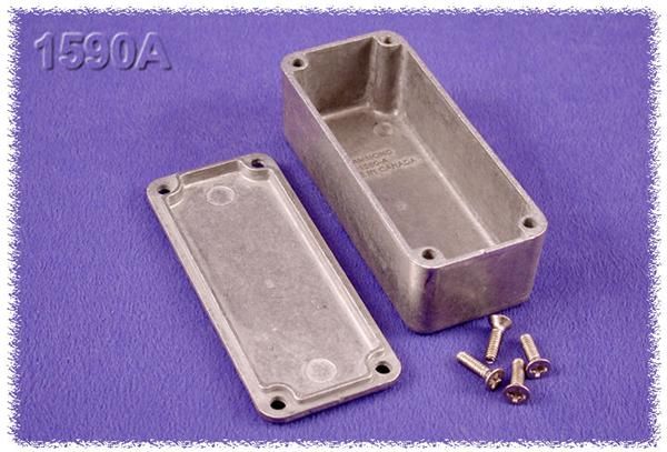

found a link for the smaller boxes in one of the threads.
just putting in here for future reference and so I dont lose it.
http://www.mouser.com/Search/ProductDetail.aspx?R=1590Avirtualkey54600000virtualkey546-1590A
