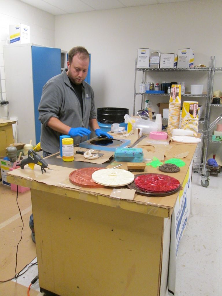

Where I am glad that I went....and I did learn some things in the morning about the various properties of all of the different kinds of molding and casting material...
what to do ..
what not to do...
I think I was the only one in the class who had actually done this sort of thing....and the afternoon was some practical applications that I have already done...
so it was kind of a snooze....
but I did come away with some knowledge.
One thing that intrigued me...which I will have to try is handling casts that are still soft....things like the larger wrist comms might be able to be bent more as they harden...worth a try...

so important I took a photo of the slide on the screen
Some of the stuff we were making in the afternoon with cold cast product, translucent product, glow in the dark tints, plastic backed with foam..
neato stuff...
