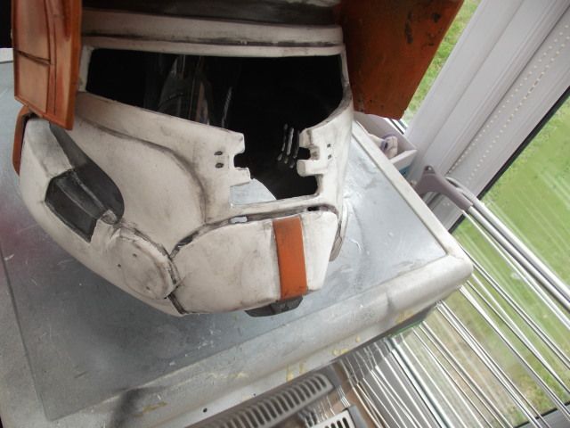

standard painting - its not a complicated paint job, basic masking and painting. then lacquer closure. I use black acrylic wash to weather, together with rattle can misting

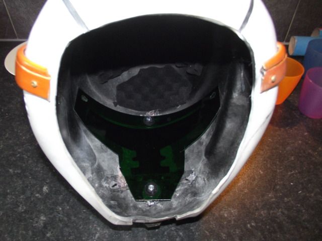

then to sort out the visor mount - I found that if you secured it into the centre; the curve of the helmet bends the edges to the curve, so 2 mounts, top and bottom. Bondo applied to ensure that the screws are pointing in the right directions
the bondo reinforcement is just me being cautious; when I did my face-off mod on the OSCS ROTS Clone helmet, the thin rim of resin above the eyes drooped in hot weather.
lens mounted, secured with washers and nuts

the visor looks high, but looking at ref pics; it actually does sit high!
teeth cut in

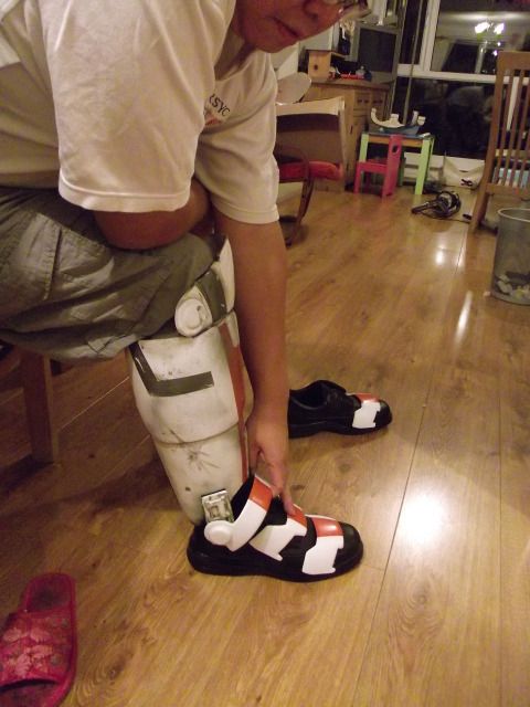

I never like the shoe part of a build - not sure why, just do. So anyways, the boot armour is very fiddly. Segment with bits not quite attached.
During the costume discussion - there was talk of shoe vs boot etc. I went with tapered shins which were seamless. Meaning not much space for a high top boot. So I went for a standard almost flat soled shoe with the heel detail
Based on ref pics - I lined up the toe cap and mid section so that they looked right and strategically covered up the shoe lace rings. In my case, flat feet makes the open tongue shoe a better option for me, but this would have been easily with a slip on!
After its aligned - tape and paint. Toe caps were attached with industrial strength velcro
the midsection had an area in the centre which required 'filling in' - I glued in an extra strip of black leather. Then with velcro again - attaching the mid section neatly over the shoe lace rings.
test fit

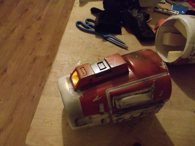

slow few days. padding added, poppers glued in, straps being made, lengths being adjusted. Slow process.
rough fit - got my thighs the wrong way round Rolling Eyes but you get the rough idea
lights installed

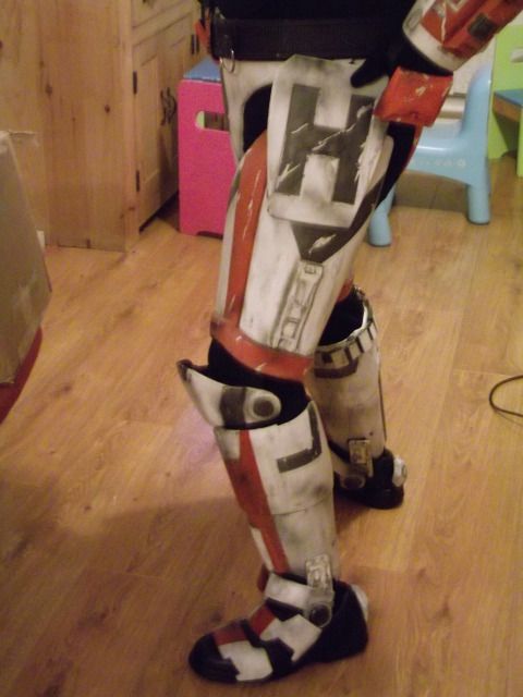

PostPosted: Sat Sep 15, 2012 11:41 pm    Post subject: Reply with quote
noticed a small button on the elbow piece - so rivet set in and painted white
well strapping is done, general fitting to see how the whole set up looks.
front view
front view with a bit of photo editing
close up of the lower limb set-up. happy with how this turned out in the end
