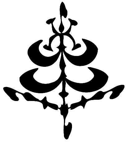

Just because I enjoy doing vector graphics, here's a quick impression of what I think the imprinted / burned out symbol looks like. As I already said, it's IMHO some kind of stylized Naboo symbol:

THANKS so much. I saw the symbol in the bodice too and appreciate you doing a graphic for me. I'm glad there is a tutorial for burn out on velvet.

Question. So I should burn out the material first before sewing or after sewing it?

After pre-washing the fabric and before dyeing, cutting and sewing the fabric; for a variety of reasons.
First, pre-wash to pre-shrink the silk velvet. Use a silk washing detergent or a MILD (=baby!) hair shampoo to do so.
Silk / rayon velvet CAN be washed and dyed in the washing machine without problems. You should just tumble dry it after you're finished with washing and dyeing, just so the 'plush' appearance is restored.
Second, burn out your design on the undyed, pre-washed (and dried!) silk / rayon velvet. It shouldn't yet be dyed because if it's still white, it's easier to place a printed version of the template for the design beneath it - the 'black on white' template will show through the considerably sheer natural colored silk/rayon velvet.
Also of course the velvet should LIE FLAT ON AN EVEN SURFACE when the burnout fluid is applied, and should be allowed to dry in that position before ironing it.
I guarantee that if you try to burn out an already sewn-up vest, you'll face HUGE problems with running or smeared burnout chemicals.
And just in case, burn out about 50% MORE fabric than you expect to use for the vest. That's just because in case something goes wrong during the burnout process (occasionally the burnout fluid likes to 'eat up' some silk backing fibers too; resulting in not-so-neat holes!), you still have enough burned out fabric.
When you've finished the burnout process, dye the fabric. No need to wash it first to remove the remains of the burnout chemicals (or the pile - that will remove itself during the dyeing process).
As I already said... you can dye it in the washing machine. Afterwards, tumble dry to restore the plush.
The dye- and tumbling processes will also show any kind of possible weak spots in the burnout areas (aka 'not so neat holes'). So you can cut around those when finally cutting the fabric. That's why I said to burn out more than you need.
Then sew.

Is the correct size I need to use please?

The size of the symbol that would be correct for your vest depends, of course, on your body size - if you're 5'3'' the size will be different than if you're 6' tall. So there's no 'one size fits all' ;-)
Best way to determine this proportional size for yourself is to have a picture of yourself taken in a doorframe (from head to toes, with the shoes you're intending to wear), with a measurement tape attached to said doorframe (which should, obviously, also appear in the photo).
Then use an image editing software to lay your photo over that of Jobal Naberrie so that your figure perfectly overlaps hers.
When you did that, you just need to cut out the measurement tape from your photo to another layer in the image editing software so you can move it around to determine the size of the symbols; the length that the vest needs to have, skirt length and so on.
After that you'll have perfect length measurements for everything you need; and just need to adjust the width in proportion to said length.
Hope that helps :-)
