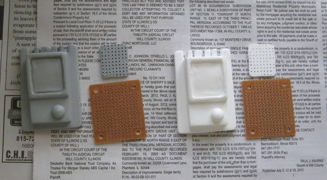

PostPosted: Mon May 28, 2012 1:04 pm    Post subject: Reply with quote
Well...
I did finish up...
first I applied a piece of the perfboard on top of the sculpt...
wasn't sure I liked that so I made the fatal mistake of carving out the area where the perfboard goes...
I say fatal because I don't have any fancy tools...
I used a hand chisel...which I don't use often and encountered some quality control....
lol..
I made a mold of my sculpt...
and this is what the final looks like...
original and cast from the mold...
I am wondering if I should make a second mold of the piece without the perfboard...
remove the perfboard....
or dig out that area on the cast...
clean up the edges...
and then add the real perfboard to the indentation on the cast...
I did order extra perfboard because, as usual, shipping was just as expensive as the product itself.
It is not great...
but most definitely better than what I had...

PostPosted: Mon May 28, 2012 2:01 pm    Post subject: Reply with quote
make that two of us. I would like one down the road myself.
FallenJedi ()
Joined: 02 Dec 2007
Posts: 3001
Location: Nashville, Tn
Medals: 7 (View more...)
Dragon Con 2014 (Amount: 1)
PostPosted: Mon May 28, 2012 3:58 pm    Post subject: Reply with quote
This is looking really good. Thumbs up As you mentioned it might be good to have the perfboard simply set in the mold after some clean up.
Posts: 17279
PostPosted: Mon May 28, 2012 4:18 pm    Post subject: Reply with quote
I am going to try to play around with it some more...
I can do anything I want to the one I cast...
cuz I can always cast another in 15 minutes...
If/when I come up with something better...
I will have to then make another mold.
I know that the holes in the perfboard did not show up well on the mold probably because of the glue used to hold the perfboard in place probably seeped up through the holes and even if that thin layer did not go all the way to the top of the holes in the perfboard (which are tiny)....it still blocked enough at the point of contact to render the holes not as prominent...
