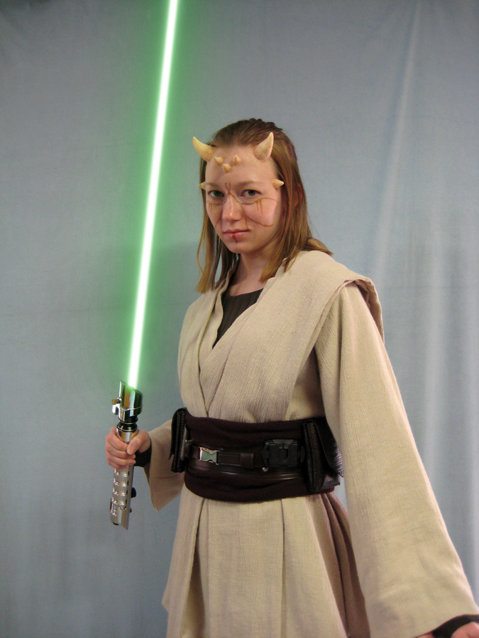

This tutorial is for making a self-scrunching Obi. I've noticed many people will simply make it taller and then try and scrunch it down manually when they put it on. My instructions will create an obi that does this naturally, and I believe is how the real movie ones were made. Take a look at this picture!
Note the wrinkles in the obi, the grain of this cotton gauze fabric, and note the diagonal weave. If you look at most obis, they are on the BIAS of the fabric, which will drape better. The few exceptions are flat obis, leather, fabrics with direction where the design needs to be straight, or something flat like Jocasta Nu's.
To start, you will need at least a yard of fabric. Cutting a bias piece for the Obi will take a lot of fabric, so take this into consideration when cutting your fabric if using the same fabric as your tunic. Your pattern will be a simple rectangle for most designs. Mine is made a little more round in shape, but I'll keep this pattern simple. You will start by drawing a rectangle and wide as your waist measurement (Keep in mind, this will be over your tunic and tabbards), and as tall as the finished measurement. It should be taller than your belt by at least 1" on both top and bottom. Add in a seam allowance on either side, and an extension on the left for your closure.
You will cut out 2 of your tunic fabric (or you can substitute 1 in a twill or canvas if you have a flimsy fabric and want some body. You can also cut fusible interfacing). Next you will pattern your bias piece. This piece needs to be taller than your body pieces by about 2" on each side at the center (more if your obi is particularly tall. My finished obi was 5.5" tall). This piece can either be a rectangle or tapered, like my pattern. If it's tapered like this, it helps by eliminating the need to do a lot of pleating on the sides. You don't need the extension, but you do need the seam allowances.
In the next step, you will take your first obi piece, and lay your bias piece on top, matching the top and bottom together. There will be excess fabric in the bias piece. Stitch down these pieces, preferably starting and stopping about half an inch in, so you can tuck in the finished edge near the extension.
Next, lay this down on the ironing board and start making your scrunches. There's no right or wrong way to do this, just start flattening, making shapes and tucks, and pressing with the iron until you get something you like. You can always repress later. Once you get any excess tucked in near the sides, you can fold under the side near the extension and hand-sew that down. On the right side, just top stitch this down.
Take your last obi piece and lay it wrong side down on top of the obi piece, making sure not to catch any excess fabric. Pin, but remember to keep one side open so you can turn it right-side out again. Stitch these together, trim, turn right-side out, turn in the open side, and hand-stitch.
Your obi should look similar to this (not the best picture, but...)
You will sew closures on the extension and the underside of the right side. I first did hook & eyes because I swore I saw some in a pic, but they were difficult to keep closed or to close on myself, so I added snaps, so I recommend snaps or velcro. Once you have your belt on, you can pull out some of your excess fabric to make the scrunching more apparent over your belt. Here's the finished product! Enjoy your Self-Scrunching Obi! Let me know if any of my instructions need clarification...

Thank you very much!! And by the way your costume looks great! Especially the combination of colors with the brown obi I like a lot.
