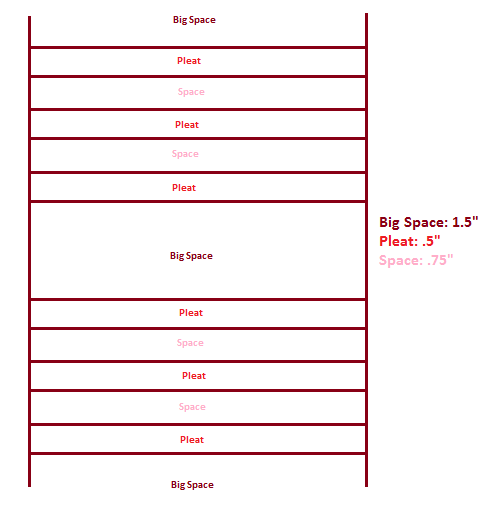

I spent 8 hours pleating today and came up with this:
The bad news is that is only enough for three sleeves, and we have six arms between us. So, I've got to do another set.
In case anyone is curious what my measurements I worked out for the pleats were, here's a handy little diagram worked up in MSPaint:
