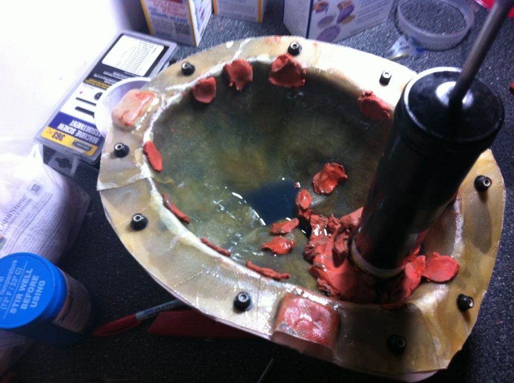

Busy last 24 hrs with the project. Last night i laid in a 1/4" layer of clay in thr negative fiberglass mold to create the void for the ecoflex Next I fiberglassed the back of the skin mold.
This morning I cleaned up the fiberglass on both, drilled out for bolts, added vent holes, and picked up an oil pump to used to inject the ecoflex into the mold.
Then came time to run a part. Mixed up the ecoflex with some black tint, added to the injection gun and filled the mold, closing off each vent hole as they started to weep.
Then came the worst part; waiting the 4 hrs for the ecoflex to cure. I'm very pleased with the outcome!

1) I know you need holes around the outer edge, but are those hole near the eyes? And possibly the nose?
Yes, i put the holes around the top edge, and ones in each eye and the nose. Though after seeing how thin the ecoflex is when I injected it..i don't think the vents in the nose/eyes are necessary.
2) Are you using like a Harbor Freight Oil Suction Gun to inject?
That's the one
3) I see you are using the trial/pint size of the eco-flex, how much did you end up using of it? All? Half? Etc.
I ended up using about 24 ounces on ecoflex. Best way to figure out how much you need for yours is to keep all of the clay you remove from the mold (the stuff you laid in to create the skin thickness) and place into your graduated mixing cup and see how much volume it took up. Or before you drill all of the vent holes...fill your injection mold with water and see how much it takes to fill. Mix up extra for waste and if you've got a couple of small things to mold, set those molds up and use your extra ecoflex for them. I needed to mold some knobs for my bowcaster build so I used the stuff there.

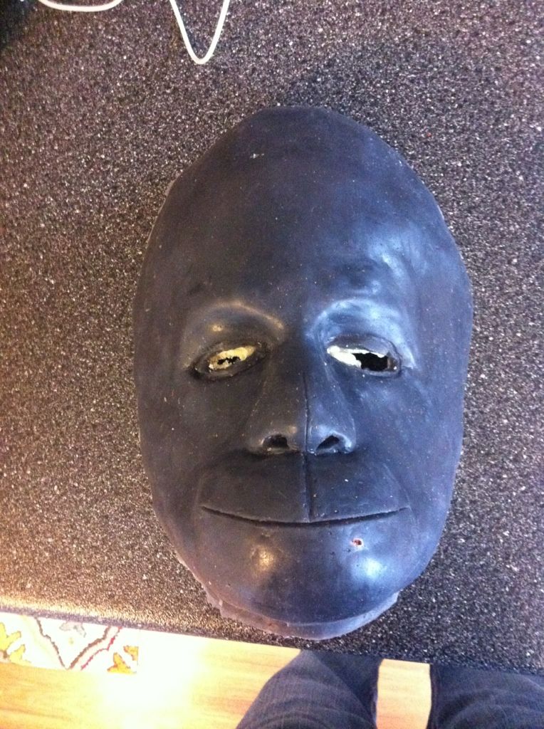

Started out this morning to create the underskull. So, I placed the ecoflex skin back into the negative mold of it. The took my lifecast bust, filled in the undercuts (under nose, lips, eyelids, etc with clay) and placed the lifecast in the mold on top of the ecoflex taking care to line up the eyes and nose. And final part of prep, wrapped the face up in cling wrap to eliminate the myriad of other small undercuts around the bust.
Then I poured in the expanding foam into the void and kept pressure on the lifecast to keep it from shifting.
After allowing the foam to cure until it was hard, yet a touched flexible I removed the mold, skin and foam as a single unit from the bust. I pulled it off early so that it still had a bit of flex to it.
Rear of the mask/underskull
Skin peeled up to show the underskull underneath.
Finished underskull and skin.

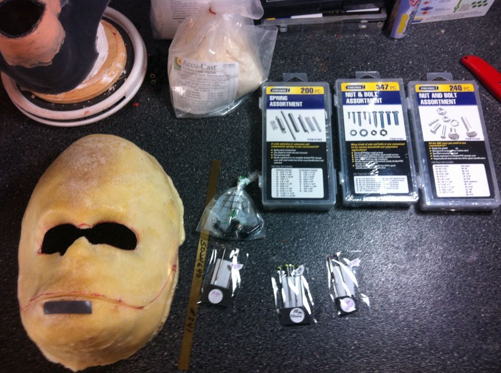

Got my crown punch needles today. Bought them com an eBay seller for $11. Much better than $40 from the fx shops on line. Also picked up a bunch of hardware to properly articulate the underskull. So time to get to it!
I'm really liking your build thread! I didn't know that we would need springs to keep the jaw closed, thought the ecoflex would handle that. It's good to know. Take a couple close ups of your hardware installation (bolts, springs, pivot points). I'm curious to see how you lay it out.

Thanks Jeff! Much appreciated! Here's a vid of the face in motion(sans snarl! How does my eye depth look?
http://s752.photobucket.com/albums/xx165/jweger77/Chewbacca%20Mask%20Build/?action=view&current=BB0EBFE2-2910-4D69-B605-6D1B5E532613-5633-000003D2558C9CC2.mp4
Here's the roughed in hardware.
