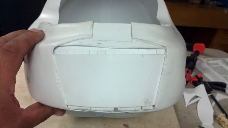

Time to cut it up. Chin comes off and the length of the chin got shortened 1/2" on each side.
Rounding off the front of the chin after the cutting has been done and the halves of the bucket are glued together. I am using plastizap for construction. It doesn't melt the styrene like ordinary model glue and is formulated for plastic work. I've used it before to glue together plastic model conversions for rocketry contests. It is strong stuff.
Unfortunately the left half of the bucket was excessively trimmed. whistling I'd have liked to have done that myself. I'll be filling that in too. After much styrene surgery and gluing my finger to the helmet a couple times we have a proper chin.

I added some more pieces to the chin to get it closer to being ready to be filed status.
Added that little bit around the left temple to fill the overtrim.

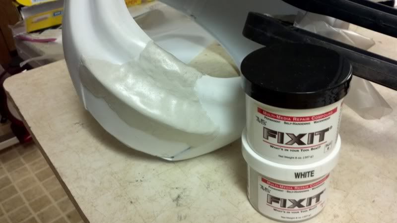

Now working on the remove the rib on the top of the helmet. I glued in some pieces of plastic to the inside of the helmet to stabilize the thing before cutting notches down the middle of the offending rib. I mixed up some "fix it" epoxy putty and worked some into the crack then clamped it down (hopefully flat)
While the rib is drying I mixed up another batch of the super sticky "Fix It" and applied it to the chin. I've worked it over a bit to smooth it out since this pic was taken but you get the idea.

PostPosted: Wed Sep 14, 2011 2:17 am    Post subject: Rib on top fixed Reply with quote
So when I left off I had cut a line down the center of the rib on the side of the bucket. Sort of a "T" actually. I mixed up some "Fix it" and squeezed it into the gap filling the cavity under the cut. Clamped it overnight and voila'
I actually fix each cut in two steps as it is so long and curved I can't clamp it the entire length in one step. Pretty slick.

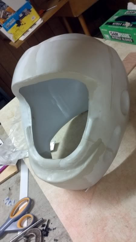

My bucket is in bondo now but I took these last week. The ridges along the sides of the helmet have been flattened nicely. I still need to do some trimming around the face and then comes fitting that face shield. I had better come up with something good for that. Any pointers on that part? The greeblies that came with the bucket didn't exactly come with directions either. I can see where a few of them go but I'm stumped on others.

I've been smoothing out the bucket with some bondo.
The second application has been sanded off now and I was reviewing the fit of the visor. It isn't pretty. Does anyone make a visor that actually looks like the real thing? The RA supplied visor is too flat, it ought to be bent in half in the middle.
Anyhow, here are a couple pics,
I wasn't happy with the way the edge of the side of the helmet wasn't lining up so I added bondo to crispen it up.
I've sanded this all out since these were taken.
