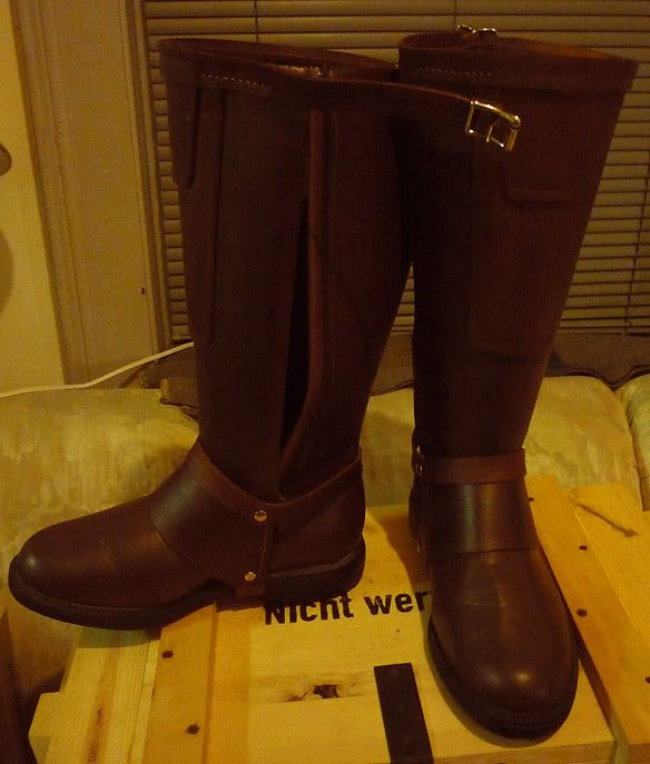

THAT is what I need to do to mine, Pandatrooper.... indeed, thanks for the tips. I modded up some of the plain brown Funtasma boots, no straps or loops, with leather pieces over the shins (comes around just enough to cover the zipper), but I haven't "aged" them yet. I will have to see about that!

Btw, it was suggested that I put together a small tutorial on how I did the leather application on the plain boots... anyone else interested? Here are my boots:

Haha, OK. I will be going back to remove the shiny buckles, btw... replacing with velcro. That was my 19th century leather working tendencies coming through when I put the buckles on Smile
