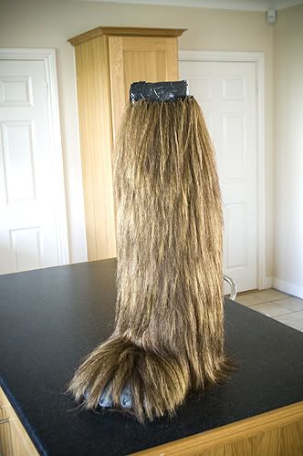

Managed to sort out my photobucket account so here are 2 shots of the feet. Some people had asked me to describe the process.
The main part of the lift is a 5L plastic paint drum.
The instep is made from upholstery foam.
The toes are latex filled with polyfil foam.
The shin supports are made from 2 wooden dowels with upholstery foam to give it shape and stop the hair draping over my actual feet.
The soles were cut from an exercise mat.
Fibreglass was used to bind the wedge heel and the drum together.
The sandals are just screwed in place.
I used black duct tape to cover most of the drum and foam.
The last step is to lacquer the hair rigid with pro-hairspray (Schwarkopf).
They give me approx 12" of lift.
The wedge slims the calf down by 3" as opposed to my last lifts were my foot was straight.
The overall foot length is 16" and each lift weighs a little over 2kgs.
Not sure how that compares to plasterer stilts but I'd say it is a lot less.
I bought a pair of drywall stilts before and never considered using them.
To top it off I would say they are virtually indestructable.

I LIKE IT!!!
With the main part of the lift being a 5L plastic paint drum. Curious as to what your shoe size is?

Size 10 EU, have no idea what that is US but basically close to 12".
The wedge heel overhangs the drum by about an inch and a half, so I have it about half inch overhang at the front and an inch at the back.

Thanks Doug, I think I can pull it off.

Do the shin supports strap to your legs? Are you able to bend at the knee at all? Any comfort or balance problems?
