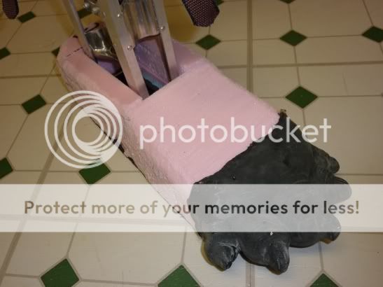

I went the drywall stilt option. I elected to go with 14-inch fixed height drywall stilts (which are both lighter and cheaper than adjustable height stilts), and that puts me at an even 7 feet. The mask adds a few inches as well, so I top out at 7'3" when it is all said and done. The feet are made from insulation foam, which is very dense but also very light. I used 2 layers of 2" foam, cut it into interlocking pieces to go around the base of the stilt, and rough carved it to shape. This pic is a very rough carve, as I did not yet have the toes. After I got those, I was able to shape the foot to blend into them.
For the soles of the feet, I went to a surplus store and found what appears to be a rubber shock absorber pad for an industrial floor buffer. It was a very stiff rubber but thin, and thus lightweight, and I used that to support the foamboard.

I almost didn’t get the toes, thanks to the USPS that gave me a “final” notice on a Saturday after the post office closed and said they'd be shipped back, even though I'd never gotten a first, second, or any other notice. But I was able to retrieve them before they went back. They're tinted latex stuffed with polyfill.
The absolute best part of all is that they fit the feet I precarved perfectly, so all I had to do was a final sand of the foam and glue them on.

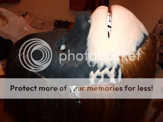

The mask! The face portion is tinted dragonskin (the minor defects in coloration are not a problem, as there will be almost total hair coverage). This is great, because I didn’t have to worry about painting it and then having the paint peel off.
One of the most interesting features of this mask is that when you open the mouth, the lips pull up to show the teeth and even snarl (although that's not in this pic).

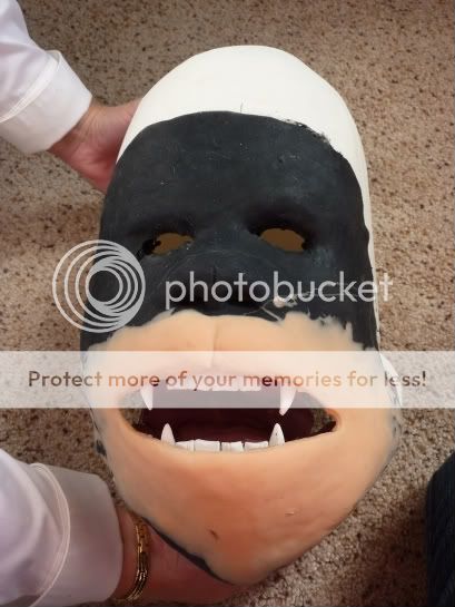

Now, onto the mask. This is the latch-hooked cowl attached to the back. This is the Wookiee Witch Doctor.
First came the padding of the mask. That took 3 days and I took it on and off so much, I actually scraped all the skin off my chin. I can't open the mask very much because of the pressure it puts on the bridge of the nose, so he can "talk", just not roar.
