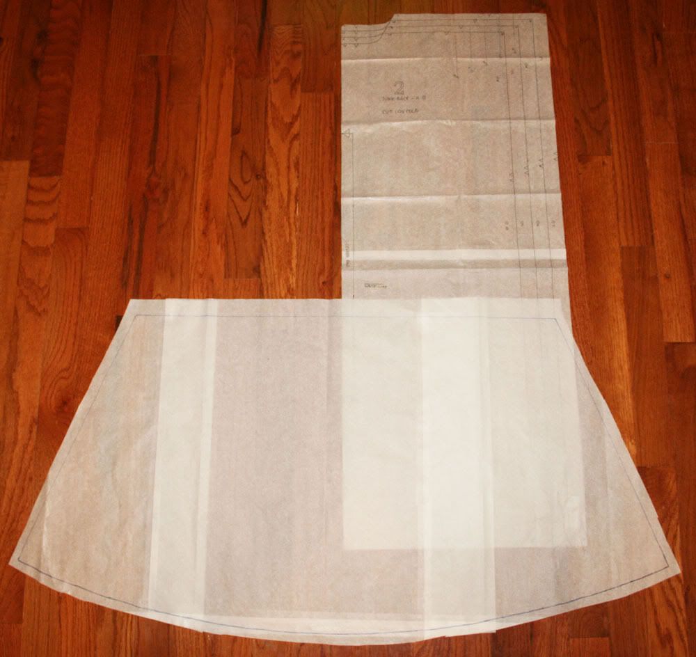

The Skirt
According those more knowledgeable, the lower portion of the OT is a skirt. Apparently, in the actual movie costume there’s a seam along the waste of the OT where a skirt is sewn to the upper portion of the OT, making the lower part of the OT a skirt, thus allowing it to drape and flow properly. This seam is hidden by the obi.
The Skirt Pattern:
This is how I arrived at the pattern for my skirt:
-Having gone through the Simplicity 4450 pattern with cheap material and wanting to cut the size of the pattern down to better fit me, I arrived at a measurement of 26 inches for the width of the back of the OT. There will ultimately be a side seam running from the base of the OT, up the sides and along the underside of the sleeve. I verified the measurement of 26 inches by measuring the width of the back of a suit coat and dress shirt.
-We know the seam for the skirt is along the waste line. Looking at some of the reference photos for OWK, we see that the bottom of the OT falls mid-thigh or approximately 4 inches above the knee (and the tabards appear to be a couple of inches below the bottom of the OT and a couple of inches above the knee. Measuring the length between the waste and a point just above the knee came to 16 inches. I actually made the measurement for the skirt to be at about the position for the tabards because I wanted a little extra for the hem. Ultimately, I cut off about four inches of the skirt when I hemmed the OT, but I’d rather have it long than not long enough.
-Using these two measurements, I created an “A”. I placed a length of masking tape, measuring 26 inches, “horizontally” on the floor. This would be the horizontal portion of the “A” that connects the two vertical sides. I then bisected this measurement and placed a 16 inch length of masking tape perpendicular to (and “below”) the horizontal piece of tape. NOTE: It turned out that this piece was not needed. I then extended this piece of tape “above” the horizontal piece by 32 inches (double the 16 inches). Finally, I placed two diagonal pieces of masking tape forming the “A” and extending 16 inches “below” the horizontal piece of masking tape. This can be seen in the following picture:
The horizontal line of the “A” represents the position of the waste. Therefore, the skirt pattern should start here. I placed tissue paper on the “A” at and below the horizontal line.
The tissue paper is the material often found wrapping gifts inside a box. In the USA, this is generally used in wrapping clothes in gift boxes. The tissue paper is thin, see through, fairly sturdy and perfect for making patterns for sewing. The only draw back is it comes in 24” squares, so you must tape pieces together for larger pattern pieces. Also, tissue paper can be ironed on the low setting (even with steam) to iron out the wrinkles.
In the above picture you see three pieces of tissue paper overlapped and taped together with Scotch tape. Next, I created a pendulum using more masking tape, a piece of string (basic string that can be bought at any department store or home improvement store) and a pencil. The next four pictures shows (1) how I secured the string at the top of the “A” with masking tape, (2) the string on the “A”, (3) the string taped to the pencil at the appropriate length and tracing the arc of the skirt and (4) the final drawing of the skirt pattern.
The next picture shows the full length of the original “tunic back” pattern piece from the Simplicity 4450 pattern laid on the skirt pattern. Note the overlap is considerable. The length of the “tunic back” pattern piece will be modified (shortened) and the length should use a measurement from where the shoulder seam would be (the top of the shoulder) to the waste (1” to 2” below the belly button).

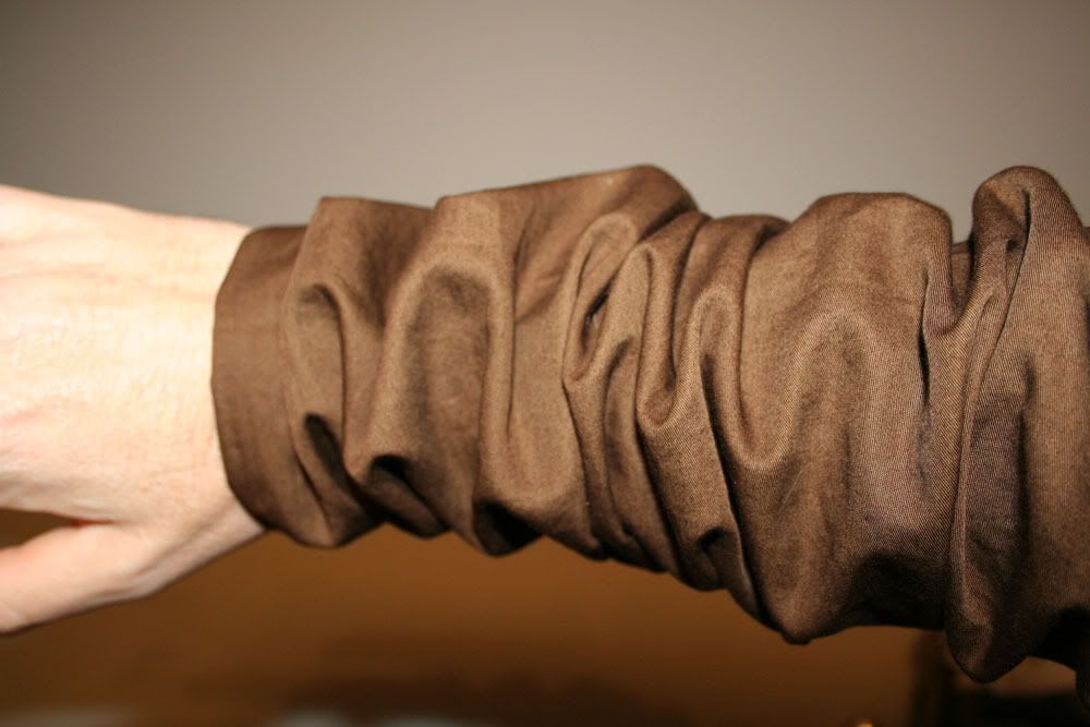

As for the Inner Tunic: I made several variations of the Inner Tunic. I ended up making an Inner Tunic the same way I did the Outer Tunic, but only a bit smaller and with no skirt, but long enough to tuck into my pants. The collar had three folds instead of one as described above. The visible part of each fold was approximately 1.5 cm. The sleeves were made too long, then bunched up and sewed in place. I secured the front of the Inner Tunic with metal snaps.
Inner Tunic Collar
Inner Tunic Finished
Sleeve bunch before being sewed together
Sleeve bunch final
