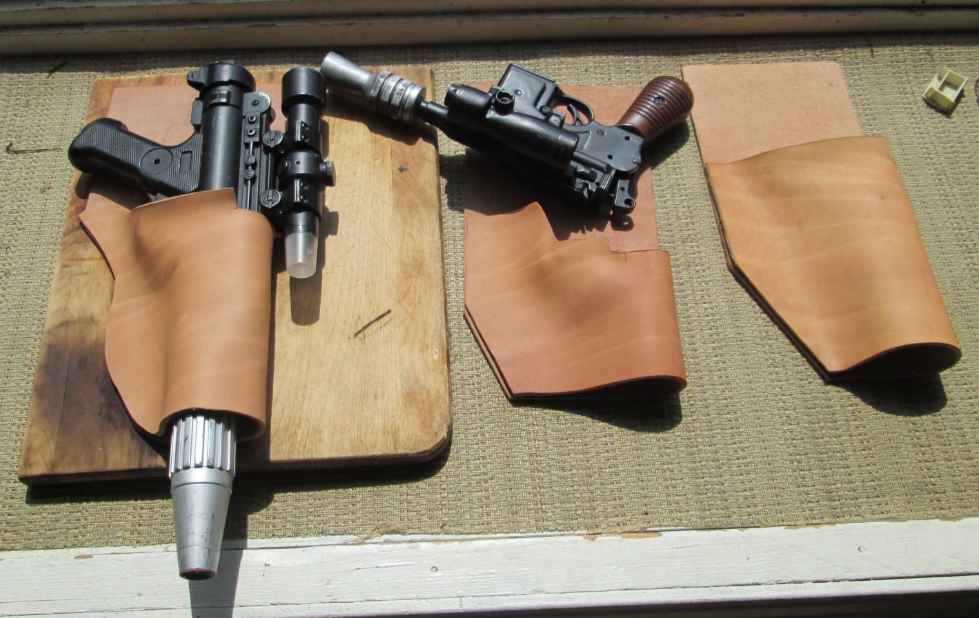

After the piece is cut out....it is time to soak the leather in warm water to get it pliable...
the squared off DH-17 piece:
the DL-44 piece:
and the more rounded version for the DH-17:
When the leather is wet and pliable....you start forming it over the blaster itself and checking fit...
While you are wet forming....you can sometimes see things that need to immediately be trimmed...go for it...
The next step after all of your holsters are wet formed is to let them dry really thoroughly....and they will keep their shape once dry....

my hands are arthritic so this part of the process is difficult for me and I can't keep as good of control as I would like. A suggestion was made that instead of using the awl to hole punch that I use a drill and small diameter bit....that actually sounds like a good idea and I plan to try that on the rounded holster.
I usually cut a piece of the stitching twine/thread that is 4 times the length of the area to be stitched. That is a little excessive but the last thing you want to do is run out of thread before you finish your seam.
I wanted to hide the knot that I make at the end between the layers of leather so I came in at the side seam with the needle.
For the black holster I used the two needle method, but for this holster I used the one needle method ..... skipping one stitch on the first pass down the holster and putting in the second stitch on the return pass.
When I got to the end...making both passes up and down the seam, I once again inserted the needle into the seam, made the small knot and tucked it into the seam.
With that done, I wanted to add the strap to keep the stock of the blaster in the holster. I had cut and dyed the necessary straps and began by putting the button part of the snap on one end of the strap...
I then attached the other end of the strap to the body of the holster with rivets...
marking location and punching the hole
With the strap riveted to the body of the holster and the button part of the snap on the strap, it was time to mark the location on the outer body of the holster to put the other part of the snap and punch the hole then set the snap.
done
Lastly it was time to add the loops to attach the holster to the belt. Again I had measured, cut, and dyed scraps of leather to rivet to the holster.
and done...
My hand stitching is far from perfect and that is mainly due to arthritis and strength in my fingers with the awl. You need to keep the awl firmly in place and punch all the holes at the same angle.
As noted, the curved holster is next and I am going to try the drill method for making the holes....
