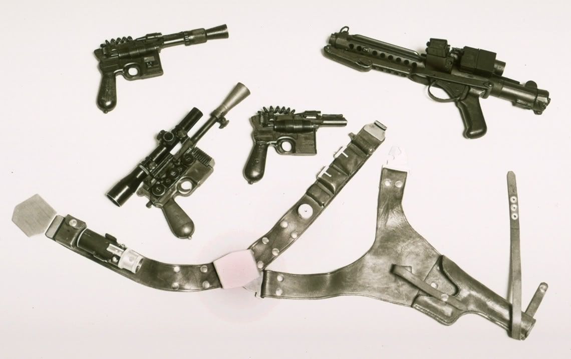

PostPosted: Wed Jan 13, 2010 12:35 am    Post subject: Reply with quote
Here is a great photo for sizing and spaceing the pieces on the belt.
