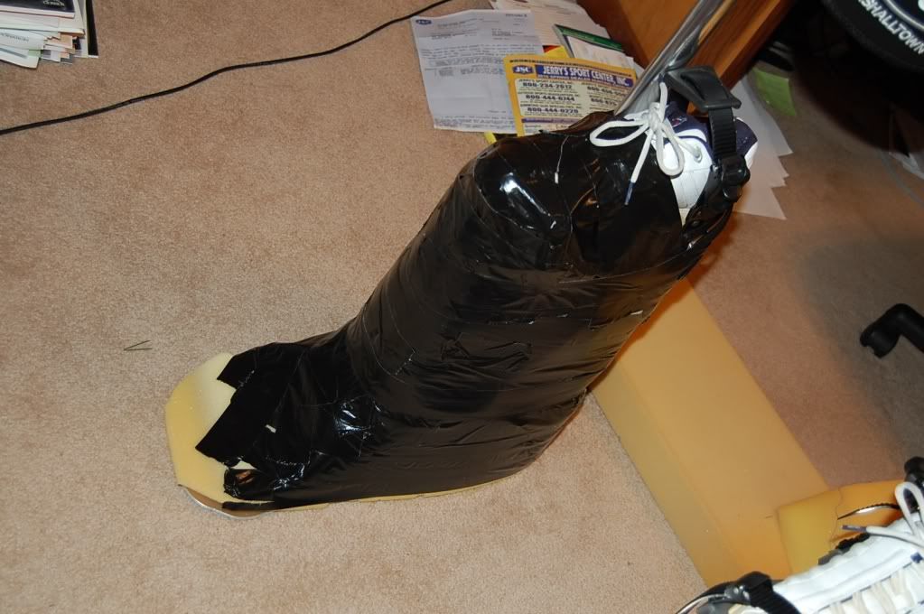

Below are pics, of start to underway Very Happy this is going to be a LOOONNNNGGG time. I have been 10 hours and have half a foot.
The feet I have begin working on, I have cut the feet out of aluminum with a waterjet CNC, and the rubber bottom is cut with the same. It is 1/4" belting with tread underneath. Will be screwing everything together before moving on to adding the foam.
Total height when completed will be 7' 8" Still have the mask coming and hopefully find some toes.

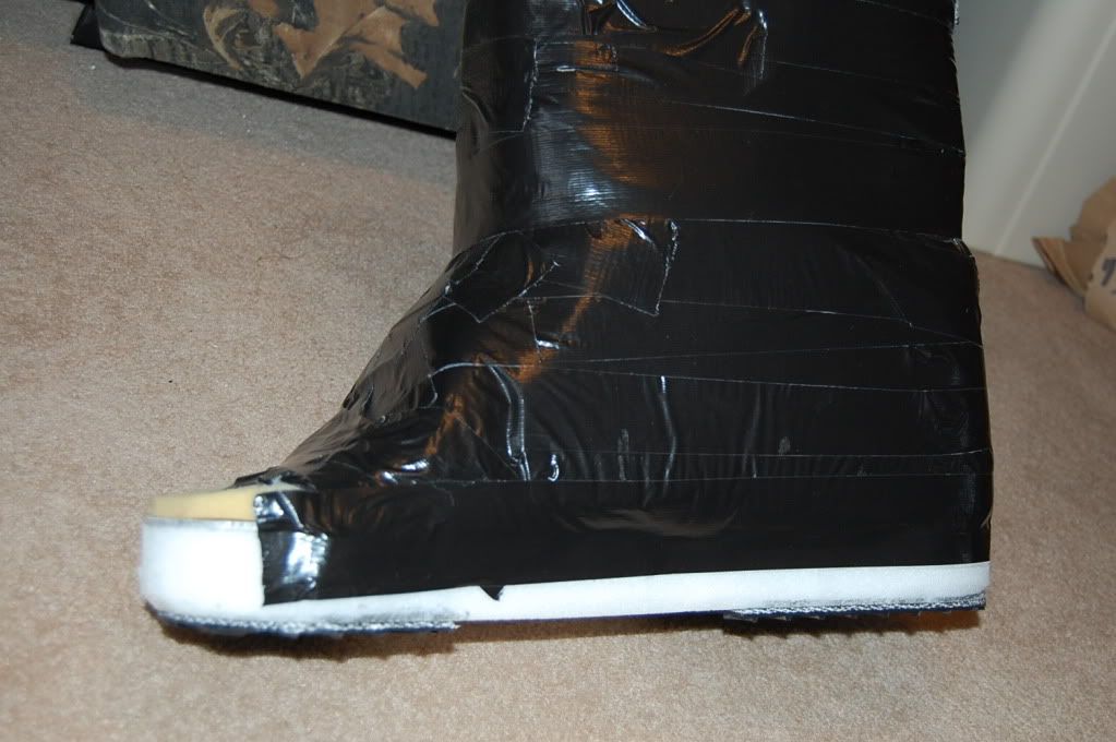

Stilts ar nearing completion. I have attached the Aluminum feet to the bottom, formed and cut the foam around the sides, and front, and added the black duck tape.
I have a poly foam 1 1/2" pad coming which will be attached to the bottom of the feet, and then a rubber belt material for traction. the only thing I need now is TOES! Toes, toes, does anyone know where to get toes? LOL

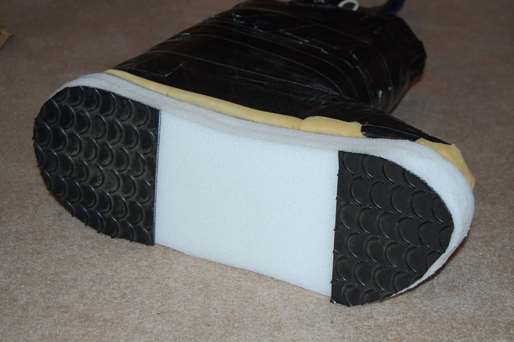

Ok still putting on hair, but the feet have turned out great. Just thought I would post up pics. The only thing left is to put on the toes and the hair.
After the last pics I purchased some very expensive high density closed cell poly foam. This stuff is light, but holds 80 lb. per square in. I glued two pieces of 3/4" foam together and glued to the bottom of the aluminum foot. I then glued the rubber belt material to the bottom for a shoe type traction.
This foot works great. The aluminum gives it structure, and the stilt with the spring allows it to flex like an ankle to walk easier.
