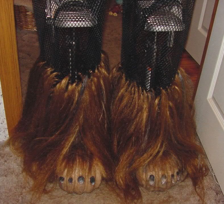

Hey guys
I’m part of the UKG and making a Chewie costume, not enough of them over on this side of the pond Smile I have a question about what type of mesh material to use to latch hook all the hair into.
I’ve currently got a large supply of this:
Does it look ok ?
I worry its not stiff enough, as you can see my by first attempt at hooking the hair into it, it really bunches up and… well, is this normal ? Smile
How ridged should the fabric be? I found it pretty hard to locate what I’ve got. Not a widely used material, hard to come by. Id ask what fabric you guys use but I doubt id be able to order it over here Sad
Cheers

This is where I was recommended to get mine from:
http://www.collinscottage.com/utilitya.htm
I haven't gotten it yet so can't chime in on how good it is, but they do ship to England.

I think the issue with your fabric of choice is that the holes are not close enough to each other. Too much fabric is between the holes if you will. When you latch your hair on it, that excess fabric is causing it to bunch up. If you look at the other fabrics posted, the fabric between the holes are allot less... causing less bunching up. I do not think its about how stiff the fabric is, as to how strong it is. There are a few places to get good netting... read up on some of the other threads on wookiee builds to save you some time and money. I know Duck put together a pretty good thread... and Matt P has a really good resource forum. I would also advise you get on the Yahoo group for Wookiees.
If you need more info, let me know via PM... and I will try and help yah get started.

Yep, there is way too much fabric there. Remember that when you tie the hair it will bunch up a little and shrink the size of the suit. On the netting we are using it isn't that much. Just enough to make it a little snug.
But on yours you could very well end up making it substantially smaller.
