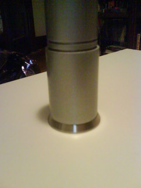

All done:
On a body:

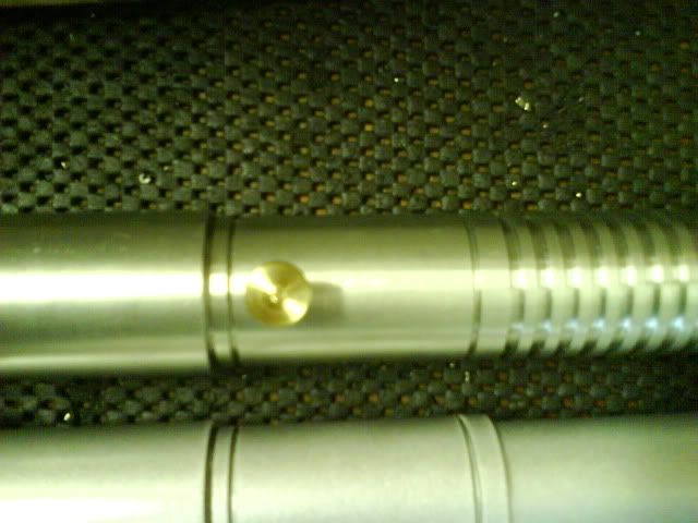

Here's the brass stock for the brass knobs:
And for fun:
The knobs should be done in a couple days, and the machinist is waiting on a new indexer to arrive so he can mill the channels into the bodies, and then that's it.

He programmed a 3-D model into the machine's computer, and the arm comes down automatically in the correct places and drills a small pilot hole, then the correct sized hole, then a small chamfer around the edges to deburr it. I tried taking some video with my phone, but you can't see anything through the plexi-screen while all the coolant is splashing about. An indexer will be used to put in all the channels, knob holes, and control box recess.

The machinist finally got his indexer and all the appropriate chucks and bits. The brass knobs are machined and threaded. He just needs to cut the little nubs off the faces. The larger silver knobs will be finished within the next few days, as well as the final mill work on the bodies.
