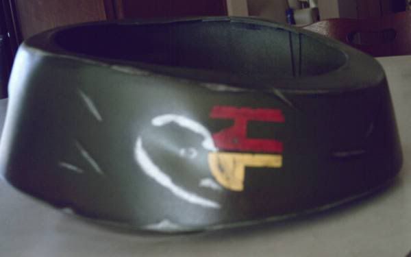

You should prime it, especially if it's made out of black plastic, like mine was.
My donut kit consisted of back and front halves, so the primer really made it easy to see if I needed to resand the Bondo at the seams.
After the primer, I then did a couple coats of silver (Rustoluem Specialty Metallics) so that it would look like "metal" if the green paint got scratched off with normal wear. I planned on doing some intentional scratches, as well.
If you're going to put any dents in it, then you need to do it before you prime it. The best way would be by using a heat gun. I didn't have one, so I carefully held my well above the burner on my gas stove, and when the plastic started to soften I pressed in with a piece of wood dowel I had handy. You could also use the end of a broom handle for a smoother indentation, but I figured that might be hard to wield, if the broom was still whole. I added a few dents to the edges as well.
When you go to do your weathering (and we know that these helmets are pretty beaten up), think about how it would to that naturally, the paint would rub or scrape off of the high spots, and probably flake and peel off around the dents. Be kind of sparing with the wear marks, don't make them even all the way around all the edges, or it won't look "natural" and it will look too "fake".
It would also gather dirt in the low spots and crevices, and also maybe the edges where it might be handled a lot.
I used the dry brush technique (dip the brush in the paint, wipe most of it off on a paper towel) for the silver wear marks and dirt.
Here's how mine turned out:
It's actually "dirtier" than it looks in those pics I took in the sunlight.
I found some rust colored primer in my garage, so I thought I'd be different, and put some "rusty" spots on my helmet by misting it at arm's length. Did that with some black, too.
After I got my decal on, and properly weathered and dirtied up, I shot the whole thing with a clear matte coat.
