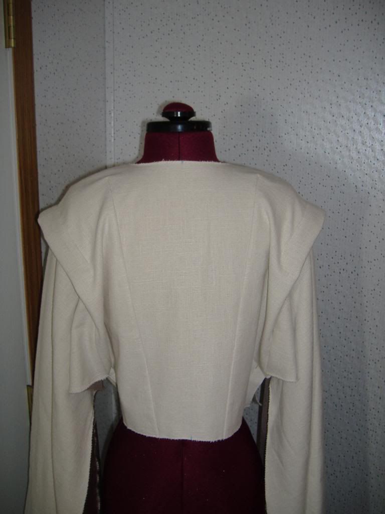

Since there was recently a question about shoulder tucks, for the heck of it I tried to take pictures as I was sewing the tucks in mine. I'm sure there are other methods and ideas, but basically this is the way I kind of understood it from the Simplicity 4450 pattern, and with some of my own interpretation, and so far this way has worked well for me.
On the dress form before the shoulder tucks (side seams are not sewn together yet, just pinned together for the picture on the dress form). Notice the distance from neck to shoulder/sleeve seam is extra wide:
One more, side view:
Iron the shoulder and sleeve seam flat, pressing it toward the sleeve (the dark fabric is the lining of the sleeve, the tan/brown fabric is the lining of the body of the tunic):
Lay your tunic down wrong side up. Figure out where you want your shoulder tuck seam to be, then measure in from the edge of the shoulder/sleeve seam to just past where you want your shoulder tuck seam to be. I used 3 1/4", marked that measurement in a few different spots, then drew a line with disappearing ink:
Form the tuck by bringing the edge of the shoulder/sleeve seam up to the line you just drew. Pin the seam into place along your line, but make sure you don't catch any of the sleeve material as you put the pins in. You're just tacking the seam down so it doesn't move around on you when you flip the sleeve over. I just pushed the pins through the seam and into the fabric underneath:
Flip your sleeve over so it's now right side up. This is why you want to make sure you don't catch the sleeve fabric with the pins you just put in. The reason you can't see the ends of the pins is because they're all inside and/or under the shoulder tuck you just formed, that way I knew I didn't catch any of the sleeve material and snag it when I flipped the sleeve over:
Pin down the sleeve along the seam that you pinned down inside, so it stays put when you pull the inside pins out:
Flip the sleeve back over wrong side up, and pull out all the pins that you tacked down the sleeve with:
Pins all removed:
Flip the sleeve right side up again. Add a row of pins on either side of the row of pins you have in the seam. Then go through and pull out the center row of pins since this is where you'll be sewing your shoulder tuck seam and they are in your way:
Figure out how long you want your shoulder tuck seam to be. Measure that out and mark a beginning and ending point for your shoulder tuck seam. I marked mine at 5" on each side of the center shoulder seam, and marked with disappearing ink. So my total shoulder tuck seam is 10" long:
Head to the sewing machine and sew down your shoulder tuck seam. If you're fabric is really thick, make sure you have a heavy duty needle. I actually used a leather needle for mine, because there's multiple layers I'm sewing through and linen fabric of this tunic is pretty thick:
Seam is stitched down:
Pins pulled. Under side of the shoulder tuck:
Top side of the shoulder tuck:
And looking at the finished shoulder tuck seam from the inside:
And on the dress form with both shoulder tucks complete:

I gotta tell you, these shoulder tucks are driving me nutzo.
I get it totally if the shoulder tuck is just on the top of the tunic. But this picture implies that the shoulder tuck goes all the way around the sleeve:
Am I missing something? If the shoulder tuck goes all the way around the sleeve, wouldn't that change the shape of how the sleeve fits into the tunic?

If you look closely at Amanda's tutorial, she does not sew this shoulder tuck stitch all the way around the sleeve. And...neither do I Wink
I only sew about 4" - 5 " on either side of the shoulder seam...and not all the way around the sleeve. The results in a stitch that is 8" - 10" long. This stitch over the top of the shoulder is visible, but will be covered by the tabards.
And yeah...for me, the shoulder tucks are probably the most difficult part of a Jedi outer tunic. I pin, try it on, then usually spend a while repining to get everything even.
I will also say that I sew the shoulder tucks in place just after I've attached the open sleeves...and BEFORE I sew the side seams (and therefore, sleeves) together. For me, it's easier that way. I hope that made sense.
