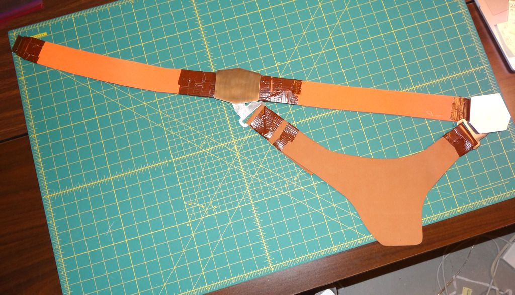

NOTE: Eventually the holster will be wet molded which is a process to shape leather by wetting it so it’s more pliable. It can then be shaped on a form and once it dries it will maintain that shape. For my holsters I do not use the actual blaster to do the wet molding. Instead, I made a wood form that is of a similar size to my blasters. If you look at the screen worn gun belts it doesn’t look like the holsters were actually formed to the blasters. I used this wood form to create the holster template.
Below is a picture of the wood form that I created. I used a wooden dowel, wood molding, and craft foam to get a proper shape and then taped it all together.
Once you are happy with your templates then it’s time to make a mock up out of craft foam and the actual buckles you will be using. For the waist belt and holster I use 3mm craft foam and for pouches and drop hip strap I use 2mm foam. I then use duck tape or painters tape to assemble the foam belt. In this build I didn’t mock up the pouches or holster because my templates are already refined. I would highly recommend mocking up the pouches and holster out of foam and using a regular needle and thread to simulate the stitching if you are creating new templates.
Below is the mock up I ended up with and will be fitting it on my friend this Saturday.

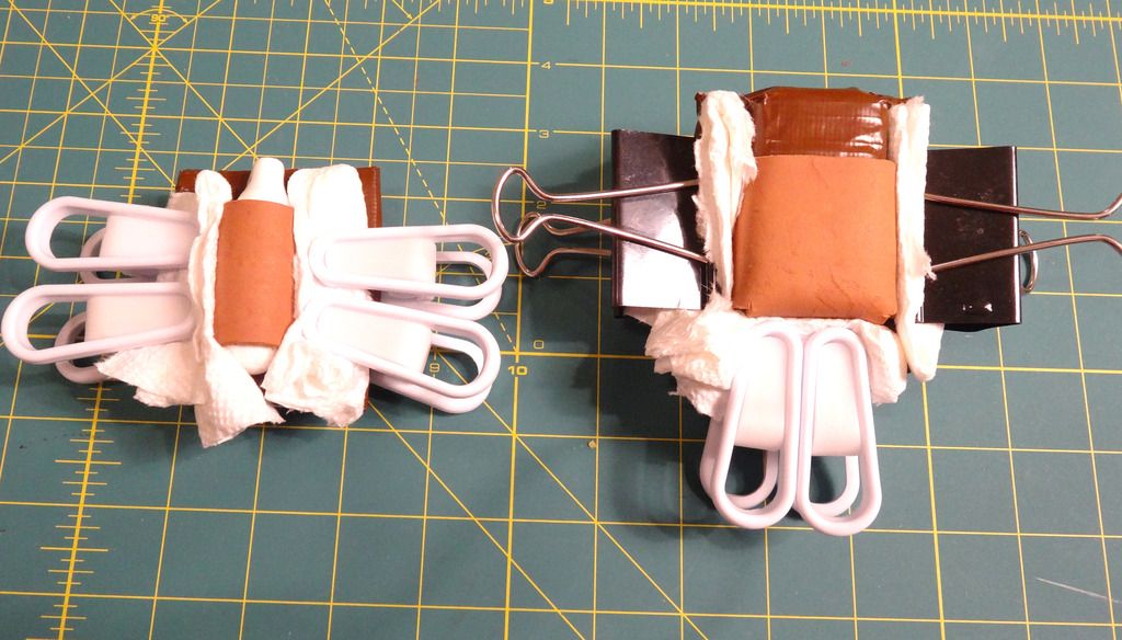

PostPosted: Wed Jul 13, 2016 4:17 am    Post subject: Wet Molding Part 1 Reply with quote
Since I need to wait to fit the mock up foam belt on my friend, I thought I’d get started on the pouches. The pouches are made from the 4/5 oz leather. When tracing the patterns on the leather, I try to keep everything as close as possible to minimize material waste. I also trace on the backside (flesh side) of the leather. Depending on your comfort level you can use leather shears or rotary tool to cut the leather. I find for the pouches, leather shears are easier to use because of all the corners.
Next, you need to create the forms which will be used to mold the pouches. I used foam board and duck tape to create my forms but you can also use wood or some other material that gives you a solid foundation.
For this part of the tutorial I’m only molding 3 of the 5 pouches. I only have 3 forms and I will reuse two of them for the remaining pouches later.
Once you have your forms, it’s time to do the molding. I use a pot and fill it with the hottest water from a faucet. Then I place one of the pouches in the water and let it sit for 2 to 5 minutes. You will know the leather is ready to be molded because it will get very soft and will bend without much effort.
The most complicated of the pouches is the one that has a flap closure. Below are pictures of how I wrap and mold it around the form I created. First I wrap it around the block form and then I place it on the flat form.
Now that you have the leather on the form, you need to hold it in place for drying. There are a few different ways to do this. Some people will use wooden blocks and then nail or staple the leather to the block. This will result in a really tight fit of the leather to the form. My technique doesn’t get as tight of a fit but it yields good enough results for the pouches. I use paper towels and a variety of clips. Binder clips work great for this and it’s nice to have a bunch of different sizes. I place a piece of folded paper towel over the leather where the clip will be placed. The paper towel prevents the clip from leaving an indentation in the leather.
To hold down the flap of the pouch for drying, I use loosely wrapped plastic wrap.
Below is a picture of the 3 pouches all clipped up and drying:

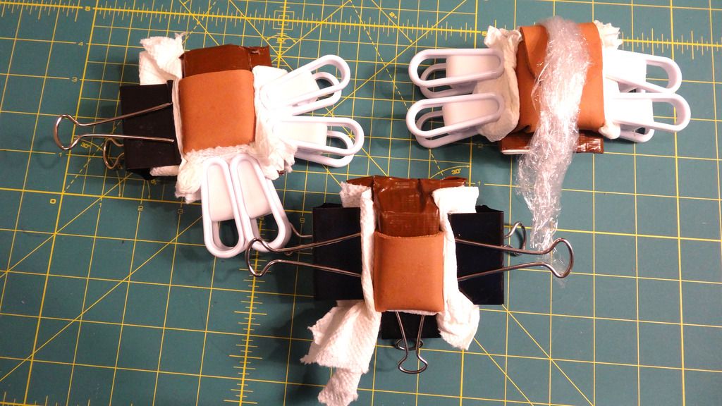

PostPosted: Thu Jul 14, 2016 12:23 am    Post subject: Wet Molding Part 2 Reply with quote
So overnight the three pouches dried and this is what I ended up with:
They don’t need to look perfect, that’s part of the charm and they’ll take on a better shape once they are sewn to the belt.
Next I still need to form the two other pouches. It is best if you have the canister geeblie to mold its pouch so you end up with a good fit.

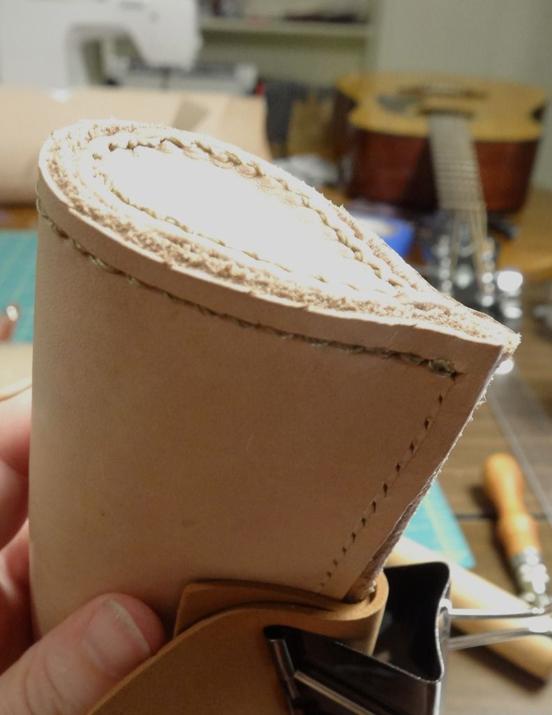

Now we are ready to start sewing the cap. This is not an easy step by any means. I had to do a few tests before I figured out a technique that worked for me. It might be a little difficult to explain exactly how I do this but hopefully I can convey at least the essence of what I do.
I treat the holster leather as the top piece of leather and the cap as the bottom piece. What this means is when I go to stitch I’m starting to pierce the leather from the holster side. Make sure that you pull out a very long tail piece of thread from the awl (see the instructional video posted above). The tail piece should be a few feet long. Also notice in the picture below I start about 3 holes in from the edge.
As a stitch I flip up the cap so it sits at a 90 degree angle to the holster leather to make sure my stitches don’t get too tight. The key here is you want to keep things loose. If you stitch the cap too tightly to the holster it won’t lay correctly. Also don’t be afraid to roughly handle the leather to get it to move into the position you need it to. Sometimes you might have to “fish” around for the pre-punched holes. Don’t use a lot of force to push the awl through, because that most likely means you will end up punching a new hole in the wrong place. If you have the holes properly aligned the awl should push through the leather without a ton of effort.
Continue stitching until you start to get to where the cap curves. We’re going to have to do a little trick here because there are more stitching holes on the holster leather than there are on the cap. Bend the holster leather around the cap and see where the stitch holes start to misalign. Pull the tail end of the thread down through the cap leather. We are now going to do a few stitches only on the holster leather without attaching them to the cap so we can get the stitch holes to align again.
Once it looks like the holes are aligned again, I use another needle to pull the tail end back through the cap leather and continue stitching.
You will have to do another adjustment when you reach the other curve.
Here’s a picture of what the stitching looks like from the inside:
Once you reach the tip of the cap you will need to pull the tail end of the thread back through the cap and use another needle to pull it through to the front of the holster leather. Now you can finish stitching the few holes we skipped in the beginning to close up the cap. Make sure to back stitch at least 3 stitches to hold everything in place. If you did everything correctly you should end up with something that looks like this:

This weekend I was able to do a fitting of the foam mock up on the extra scruffy looking nerf herder I'm making the gun belt for. We're slowly working together to get his ANH Solo up to RL standards. I also got to switch roles this weekend and try out my ANH Senatorial Leia costume I've been working on.
The fitting went really well and I only had to make a few minor adjustments so I should be able to cut the rest of the leather soon and then I can get everything dyed.

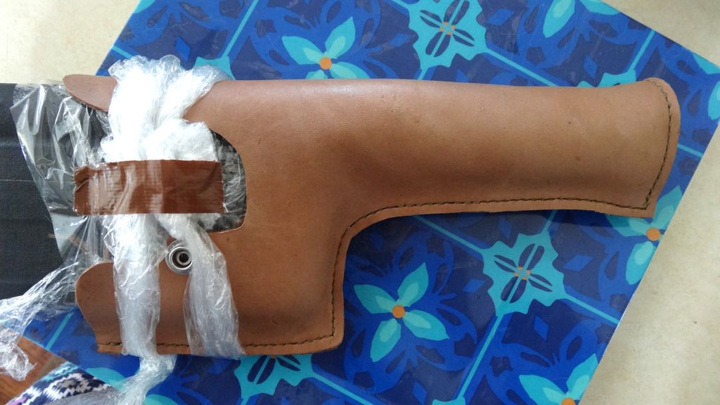

Now it's time to mold the holster to the block form. Soak the holster in hot but not boiling water for 5 to 10 minutes, until it's really pliable.
I wrap the block form in plastic wrap before I place the holster on it. Once the holster has soaked long enough place it on the form and make sure the part of the holster for the barrel is completely supported by the form. If you have a little gap near the cap of the holster, take the form out and add a ball of plastic wrap to the tip of the block form to help fill in the gap. Place the holster back on the form and see if the extra plastic wrap minimizes the gap.
I then use additional plastic wrap to loosely hold the top of the holster in place on the form. Let the holster air dry.

Now that the leather is dyed, we are almost ready to assemble everything but first we need finish the back side of the leather so it won’t shed on your clothing. There are a lot of different ways to do this. I’ve taken two approaches.
Let me start off by saying that duck tape will totally work Smile This is for the, “oh shoot I gave myself an unrealistic deadline to finish this costume and now I have a time crunch” costumer. I am completely guilty of this. If you do go with this approach, get a color of duck tape that’s light brown or beige and don’t tape all the way to the edges of the leather so it won’t show. It completely works and no one will know the difference until you take the belt off.
Now if you give yourself plenty of time or you are making the gun belt for someone else, you probably want to do this properly. The belt blanks I get from Tandy tend to have very rough backs. If you don’t finish the backs of these you will end up with leather fuzz and light colored rub marks on your dark colored pants. Here is a picture of the rough back of the belt blanks and you can see all the leather “fuzz”.
The ultimate goal of finishing the back of the leather is to get a nice smooth finish similar to a leather belt you buy at a store. This first step you really only need to do if your leather is as rough as the picture above. You probably won’t have to do this on the lighter 4/5oz leather. To start the smoothing process, I take a skiver and shave off a thin layer of the back leather until it has a smoother texture. A skiver is just like a giant razor, so essentially we are shaving the leather. Be sure to not press too hard or you can create deep unwanted gouges in the leather. It won’t be completely smooth but the goal is to take off most of the leather “fuzz.”
Here is a picture showing the difference between the non smoothed leather (towards the back) and the leather smoothed (towards the front) with the skiver.
Once you are decently happy with the smoothness of the leather we are going to burnish the leather to give it a more professional smooth look. There are a few different products you can use, some people use saddle soap but I’m going to use gum tragacanth. For this step you will also need something to burnish the leather with, I just use the back of a big spoon, and a brush to apply the gum tragacanth.
When burnishing the leather I work in small sections because the gum tragacanth will start to dry and get too gummy and sticky. I generously coat a section of the back side of the leather with the gum tragacanth and then I rub it in with the back of the spoon using quick movements and quite a bit of pressure. We are technically polishing the leather and want to build up some friction. If you are using a metal spoon like I am be careful because it might start getting hot and if it does then you are doing a good job.
You only need to burnish the back side of the leather pieces that will be up against your clothes so this would include the belt, holster drop strap/y connector, and leg strap. Below is a comparison between two pieces of leather, one has been burnished and the other one has not.
Now that the back sides of the leather are properly finished, it’s time to start the extra fun step, assembling the gun belt and I’ll cover that in my next post.

Now it’s time for what we have all been waiting for, the assembly of the gun belt. I start with attaching the buckles and closure hooks first then I move on to attaching the pouches. The following steps will vary based on the hardware you have. My hardware is from Todds Costumes.
First I attach the front buckle and closure hooks. Here is a picture of one of my finished belts with the front buckle and closure hooks attached.
Each closure hook is attached differently. The left closure hook will be permanently attached to the buckle and the curved part of the hook wraps down around the leather as seen in the picture below.
You will also notice in the picture that I’ve trimmed off the corners to give the finished product a more refined look. Also the leather strap is slipped underneath the closure hook lip which permanently affixes the hook to the buckle.
Once I get the hooks in a place I’m happy with, I mark the holes where the rivets will go with a pencil. I then make the holes using the properly sized leather punch and set the rivets. If you don’t know how to set rivets, YouTube has plenty of tutorial videos. I do a similar process for the right closure hook. This hook is a lot easier to put in place because it’s not attached to the buckle. The lip of the hook faces up and does not wrap around the leather.
Now with the front buckle and hook closures in place, it’s time to fit the belt and get the back buckle attached. One of the issues I’ve encountered is that the 2 inch wide leather belt strap does not fit through the loops on the back belt buckle because it’s a bit too wide. In order to get the leather to loop through the hooks on the back buckle some trimming is required. Below is a picture of what we will be attempting to achieve in the next few steps.
In the pictures above, you can see the leather folded towards the back of the belt has been slightly trimmed along the edges and then everything is held together using snaps. I slowly trim the leather down so I can start getting it through the loops of the buckle. Less is more here, you can always take off more leather but you can’t put it back on. I’ll trim the leather and then put it through the loops on the buckle, tape it in place using painters tape and then try the belt on. I’ll continue this process until I have a fit I’m happy with.
Next, the leather needs to be thinned out where it will be looped through the buckle. Using a skiver, slowly remove some of the flesh side of the leather where the belt will be folded.
After you remove a bit of the leather test the fold and see if the leather bends more easily. Continue this process until the leather bends easily and lays a little flatter near the fold.
Now it’s time to determine where the snaps on the back of the belt will be placed. I use painters tape to temporarily attach the leather to the back buckle so I can figure out the snap placement. If you look at pictures of Han’s belt the snaps are not placed equidistant. The first two sets of snaps closest to the buckle are closer together and then the third set of snaps are set farther away. Depending on the size of your belt these distances will vary. I lay all the pouches and disk on the belt so I can get an idea of how much room I have to work with.
Below is a picture of one of my finished belts vs the belt I’m working on, so you can get an idea of how to do the spacing.
I also cover the portion of the belt where the snaps will be with painters tape so I can mark the snap placement without making visible marks on the leather.
Once I have the placement for the snaps, I unhook the leather from the buckle, and unfold it so the strap lays completely flat. I use a leather punch to make the holes on the outside facing part of the leather which is where the painters tape should still be in place where I marked the location of the snaps. Once I make these holes I then reattach the leather to the buckle and fold it into the final position. I use a pen to poke through the holes I made for the snaps to mark the back piece of leather. I then use the leather punch to make these holes.
Now it’s time to set the snaps in the leather. You can learn how to do this by looking for tutorial videos on Youtube, look for things like leather snap setting. One word of advice with this step. I would keep the leather looped through the buckle when applying the snaps. Sometimes it may be difficult to push the leather underneath the buckle loop once the snaps are attached. Below is a picture of how the snaps should look.
That’s it for now, in my next post I’ll talk about the holster assembly.
