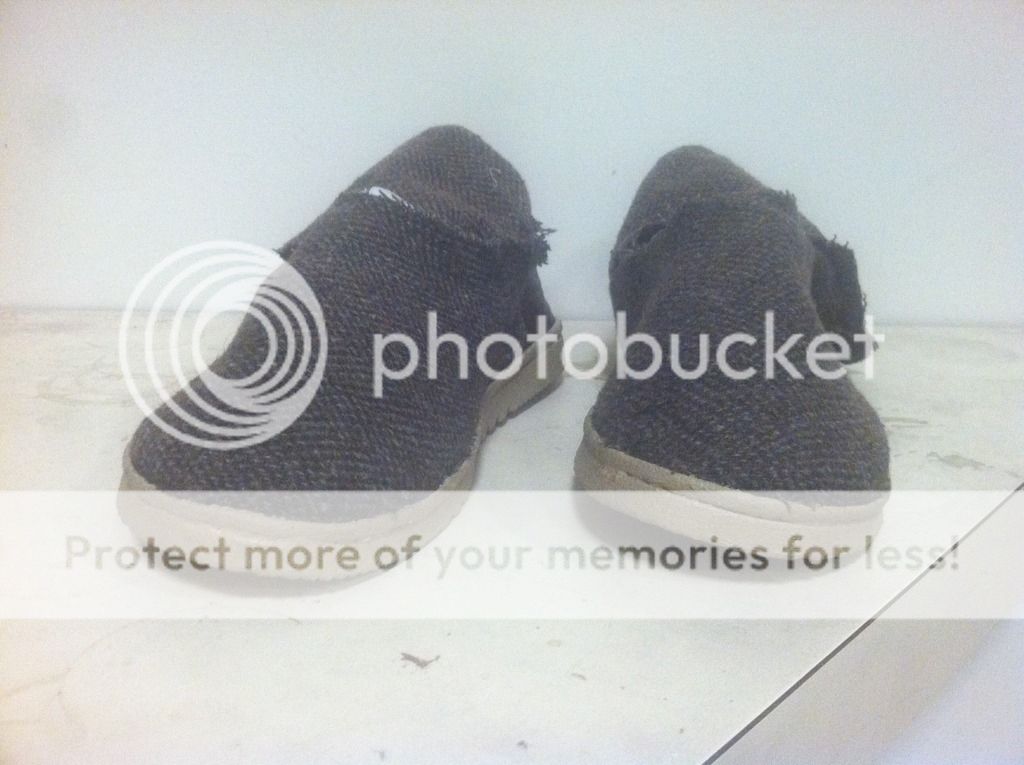

The subtle variations of color from the tweed were still visible under the dye, so it came out really nice. Now for the pattern. Since the Dearfoams bootie I’m building these from were so cheap, I went ahead and bought a second pair to cut apart in order to get an accurate pattern for cutting the fabric. Here are the component parts of the boot:
Once I had the pattern parts, I found it was quite difficult to find fabric on the jacket that was large enough to cut the pieces without having a seam in it; so if going the thrift-store jacket route for your fabric, take the pattern pieces with you when shopping for the jacket to make sure you will get the pieces you need. I was lucky here; it just barely squeaked through. Time to start the actual boot. I started by cutting the leather for the heel and sewing it to the fabric for the foot. Here’s a quick test fitting:
Both the leather heel and the fabric of the foot should overhang the sole of the boot by 1/8”-1/4”. My original plan was to glue the leather and fabric down right to the edge of the sole, and then cut off the excess right along the edge of the sole. I felt, though, like even doing that the boot would still look like a cheesy boot topper instead of an actual boot that was made to look like Rey’s boot; so I decided to actually press the excess fabric behind the edge of the rubber sole, between the sole and the boot. Gorilla Glue is making an excellent Super Glue gel formula that works really well for this. Starting with the leather heel, I pulled the fabric of the original boot foot away from the rubber sole and squeezed a little super glue into the crease:
Then I pressed the leather into the crease and held until the glue dried:
Before doing the same with the brown tweed fabric of the foot, I masked off the sole of the boot, pulled the tweed fabric back, and sprayed the foot area of the original slipper with spray mount:
Then I stretched the tweed over the foot and repeated the process of super gluing the fabric under the lip of the rubber sole:
You can also see here that I have already sewed the fabric for the back of the boot shaft onto the top edge of the leather heel patch, in preparation for the next step.
With that, we have a complete foot section! Repeat for the other boot, and we’re ready to move on to the boot shaft…

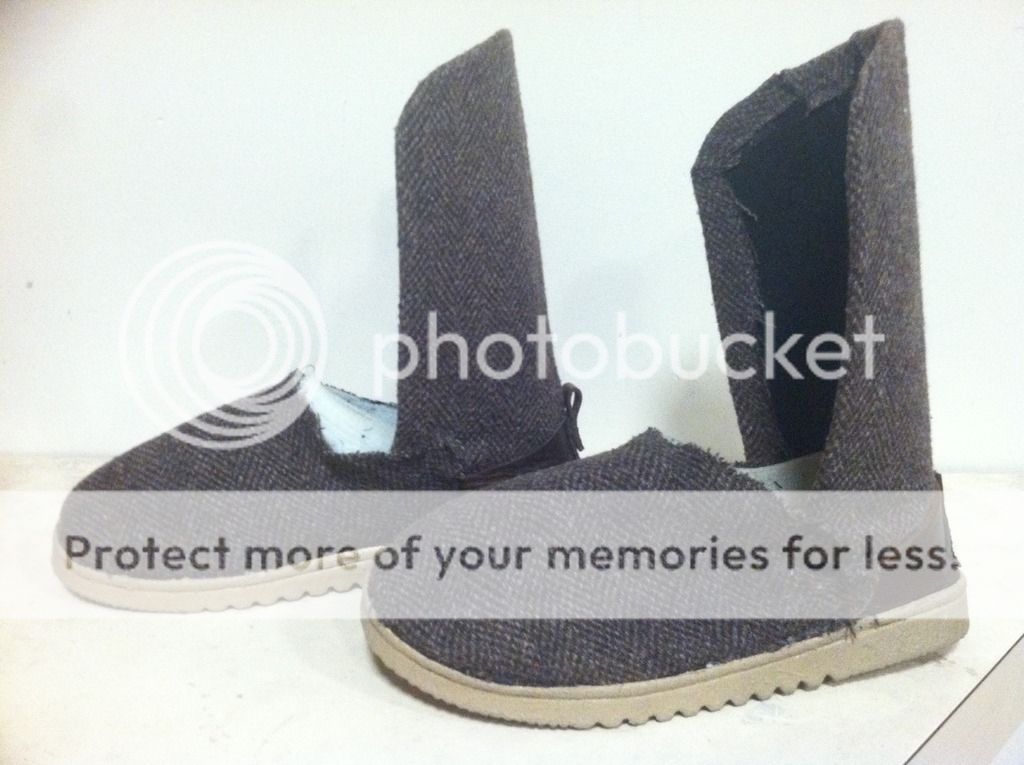

With the foot part complete, we can now move on to the boot shafts. As previously stated, these types of boots all tend to have somewhat puffy, fleece-lined shafts that really look a little too full for Rey’s boots. To correct this, I used a very stiff, heavy felt I bought at Jo-Ann’s. Heavy interfacing would probably work as well. The front of the boot shaft overlaps the back, so we’ll have to put the back in first. Here is the basic shape of the back shaft:
Since the fabric covering for the boot shaft has already been sewn onto the leather heel, we’ll go ahead and install this piece into the foot of the boot. The foot is made of basically two parts; the original grey fabric outer shell which was covered with the brown tweed, and a lightweight foam type lining. Pull the lining inside the heel of the foot away from the outer shell and glue the felt shaft to the outer shell:
I used Household GOOP to do this. Others like E-6000. I think the GOOP sets-up a little faster and has more body, but either will work. Then, glue the foam lining back into place against the black felt:
Next, I wrapped the foot portion of the boot inside a plastic grocery bag and sprayed the outside of the black felt with spray mount:
After that, pull the fabric outer covering up over the black felt shaft, stretch and smooth out. Finally, pull the excess fabric up around the edges and glue or sew into place. Repeat for the other boot, and they’re nearly done…

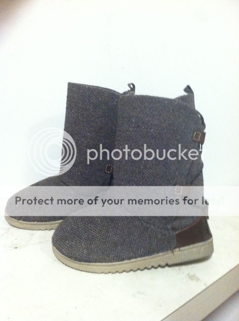

You’ll need a front on it though…you can’t get by with just half a boot!! So let’s get this thing finished up!!
The process for the front is basically the same as the back. I sewed the fabric for the front boot shaft to the foot portion of the boot, like so:
Then I cut the shape for the front shaft from the heavyweight felt. Same process as the back shaft; I sprayed it with spray-mount:
And placed it behind the fabric I had previously sewn to the foot. Stretched the fabric over the felt and glued the excess fabric down around the edges toward the inside of the felt shaft. At this point, we basically have boots!!
All that’s left now is to sew the little leather tabs to the front part of the boot shaft. These will be used to lace the ties through. There are two on each side of the boot shaft:
The last little detail is the leather up the back of the boot shaft. The little strip that runs up the leather portion of the heel has a little loop at the top of it that’s also used for lacing. The strip that runs up the shaft from the heel on up is the only part I had to use vinyl to complete. The shoes didn’t have a continuous piece of leather long enough to make this strip. That strip also has a loop on the end of it:
Now just run the lacing through the loops and we have a reasonably good imitation of the PoZu boots. I used elastic cord left over from the goggles for the lacing in the back, as that seems like what comes on the PoZu boots, but I think leather lacing would look just as good:
