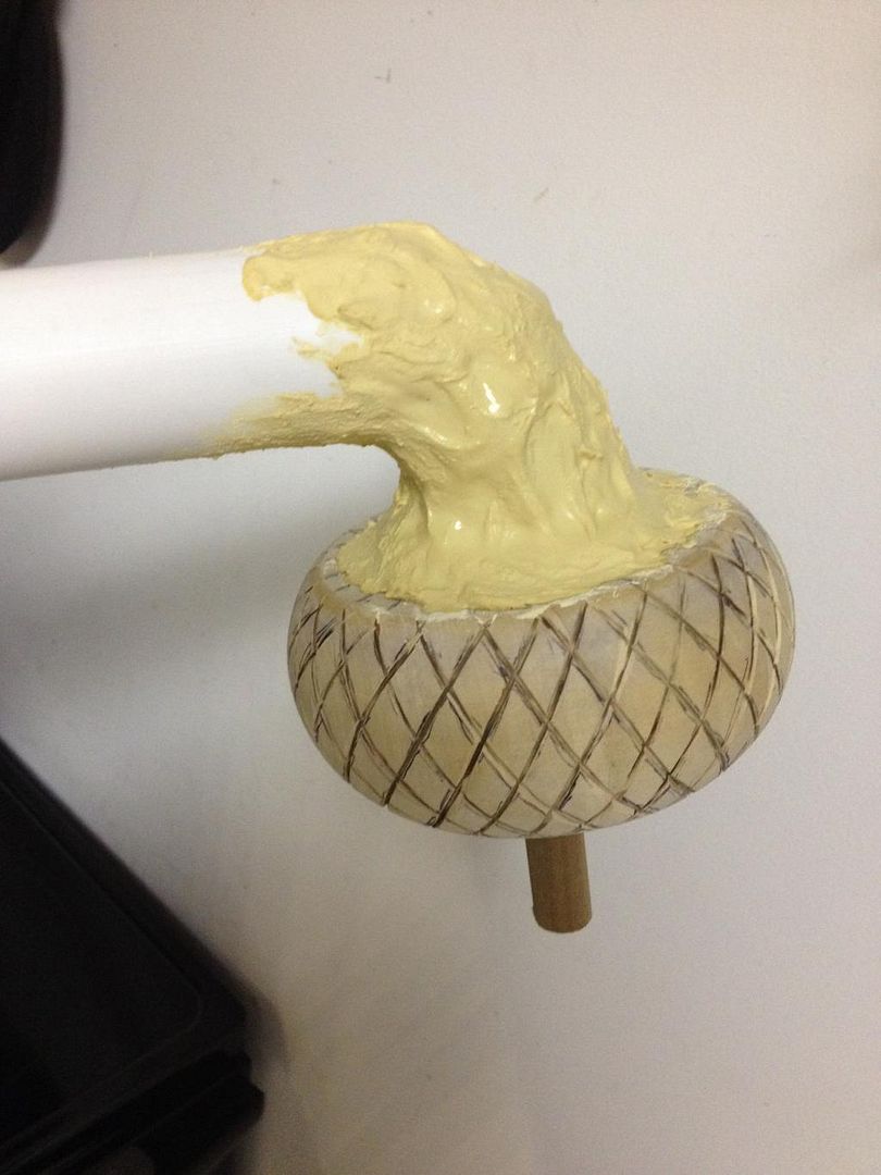

Started with 1 1/4" schedule 40 PVC pipe and heated it up. It wanted to fold so I twisted it. I think the twisted areas will help it hold the filler I'm going to use.
Used a 5" wooden foot found near the table legs and such at Lowes. Removed the screw and drilled the hole all the way through and larger. I then drove a dowel through the hole so it extended out of the other side just long enough to go into the bent section of PVC. I cut the dowel off on the spike side approximately how long I want it to be.
For the mace end I started with a 3/4" black plastic 2' pipe section I found at Lowes and a 94¢ tent spike from Walmart. Chopped off the flat base of the tent spike and crammed it in the tube. This will be cemented in place.
Free handed some lines on the wooden foot for the gaffi club pattern then used a crapton of dremel wheels to cut it into the surface. Afterwards I quickly went through each of the lines with a triangle file. I may do this again for more definition.

The bend coated in "Durham's Water Putty". This whole project is an experiment with things I've never used, apparently. I'm using it in the same manner you'd use body filler. This was last night and should be dry today for sanding. Seemed rather hard, not unlike body filler but took longer to dry. No chemicals or fumes. Part of me is considering a thin coat of resin over this.

Made a "collar" sort of bit out of the plumbing putty where the large pipe transitions to the smaller end.
Sanded down the "hook" area, then formed the pointed end around the dowel from more plumbing putty (I should really get paid for endorsing this junk).
Built up around the base of the pointy bit with more Durham's Water Putty (tm).
