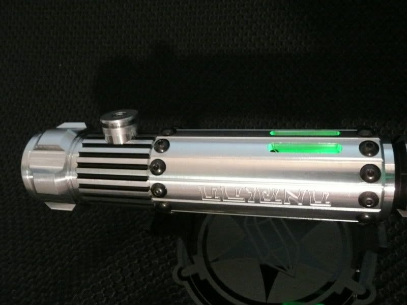

I have a similar build in my custom saber. The main difference is the piece where the switch box goes that has the crystal chamber. I also didn't go with the extension that had the neck on it. Other than that the builds are similar.
I know when I got this made originally, the plan was to go with 2 AA batteries but the battery pack was too thick (although with a little shaving could fit). The 4 battery pack was way too long (especially with the crystal chamber and switches where I had them).
I think we ended up going with a custom built battery pack that held 2 14500 Li-Ions. They do have a AAA battery pack but I believe the 14500 Li-Ions last longer. I'd have to double check with my sabersmith. My current saber will last about an hour if kept on all the time. I did a long parade and it died towards the end...lol. Anyway, here are some pics.
