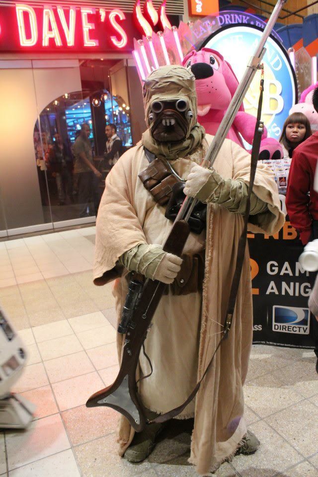

Nice work! I made one also for my Tuskin.
