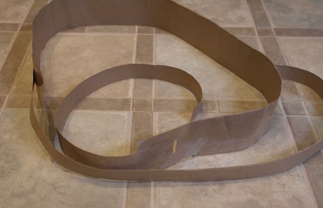

1. Make a paper mock-up of the belt first, in order to get more accurate measurements.
